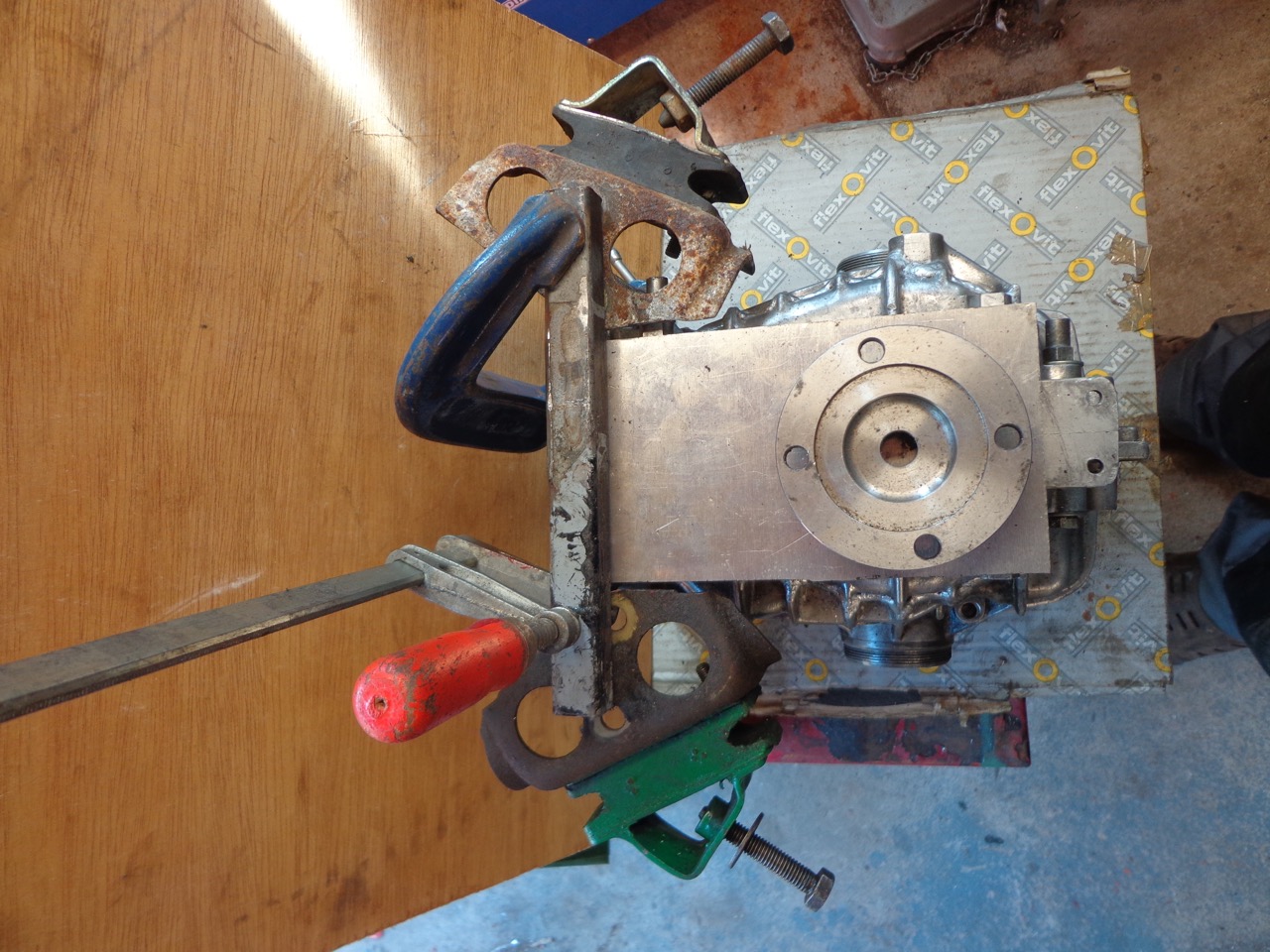

First time REAL use of the Milling machine.
Milled the back of a gearbox....
More bigger bits to follow.....

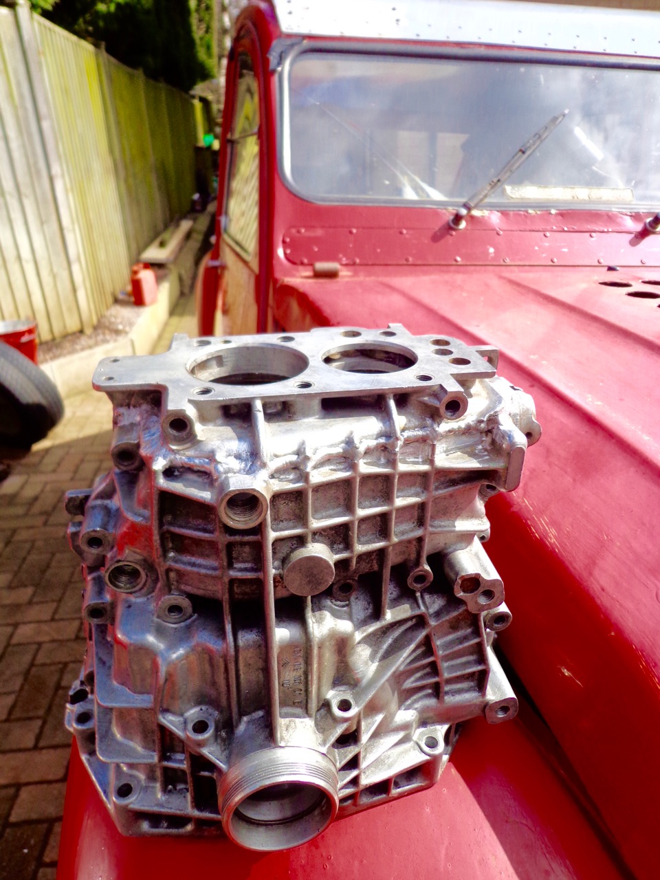

Posts: 2251
Milled the the gearbox flat, need to get the back welded on, and then get the shaft shortened.
Gearbox is about 9cm shorter.
The plan being..... to put a standard steering set up on the front, this stumpy gearbox will just fit, with the drive going under the cross tube.
Well thats the plan :?

Posts: 2251
@Jasu, In the past have paid silly money to get things made, small machine shops are becoming extinct here, so DIY extends the budget, Its also very satisfying.
Made a dummy lay shaft, fitted the main shaft, with is new bearing, all aligned, ready to get it welded :o

Posts: 2251
Very pleased with the welded gearbox, Thanks to Ian at http://www.allisport.com/
