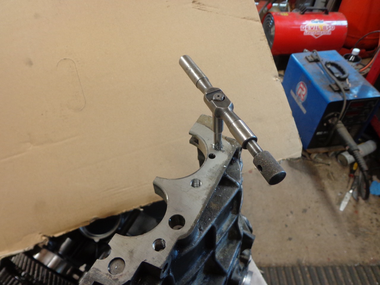

Made a carrier for the new rear lip seal.
As M9 are difficult to source, drilled/tapped the casing for M10.

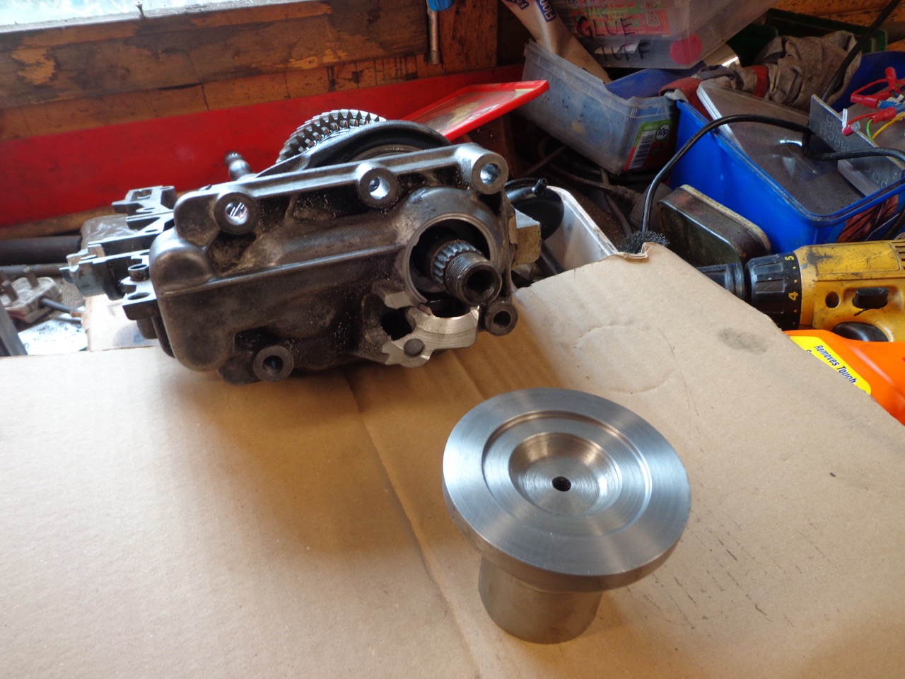

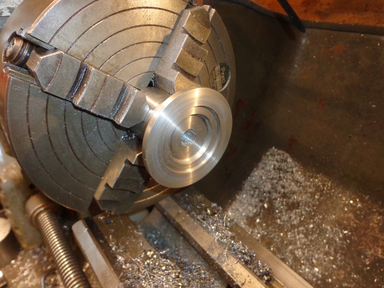

Gearbox output flange sans splines.
Doesn't look much, but a local machine shop would charge about £150+.
May try and get the splines "wire eroded", else its a weld to the the syncro flange, not that bad as its a weld similar in dimensions to skinny prop shafts.
WIP
Untidy End.
Tidy End
