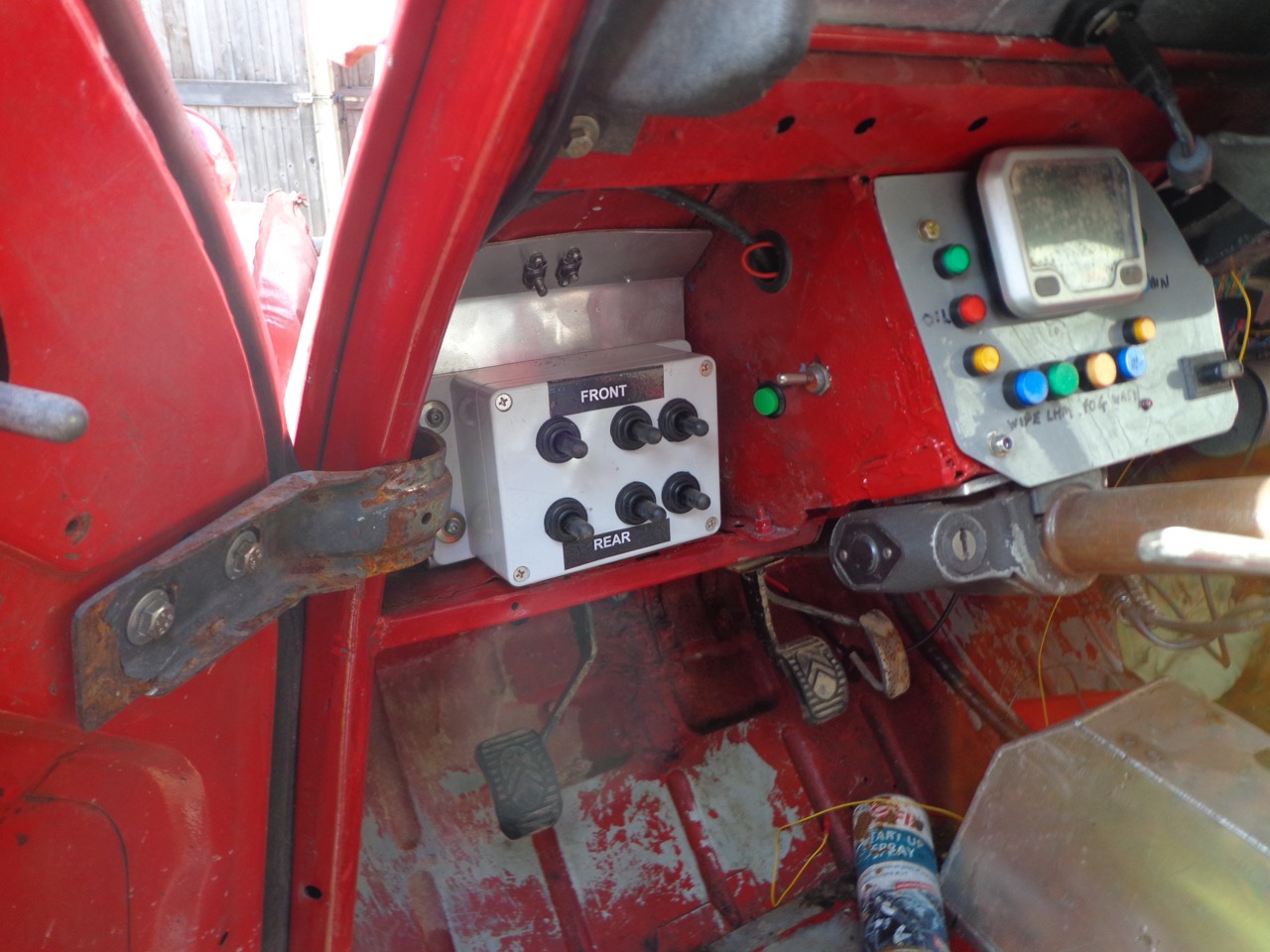

Quite sunny and warm this morning so I mounted the Suspension Control Switch box.
Accessible, but out of the way also.
