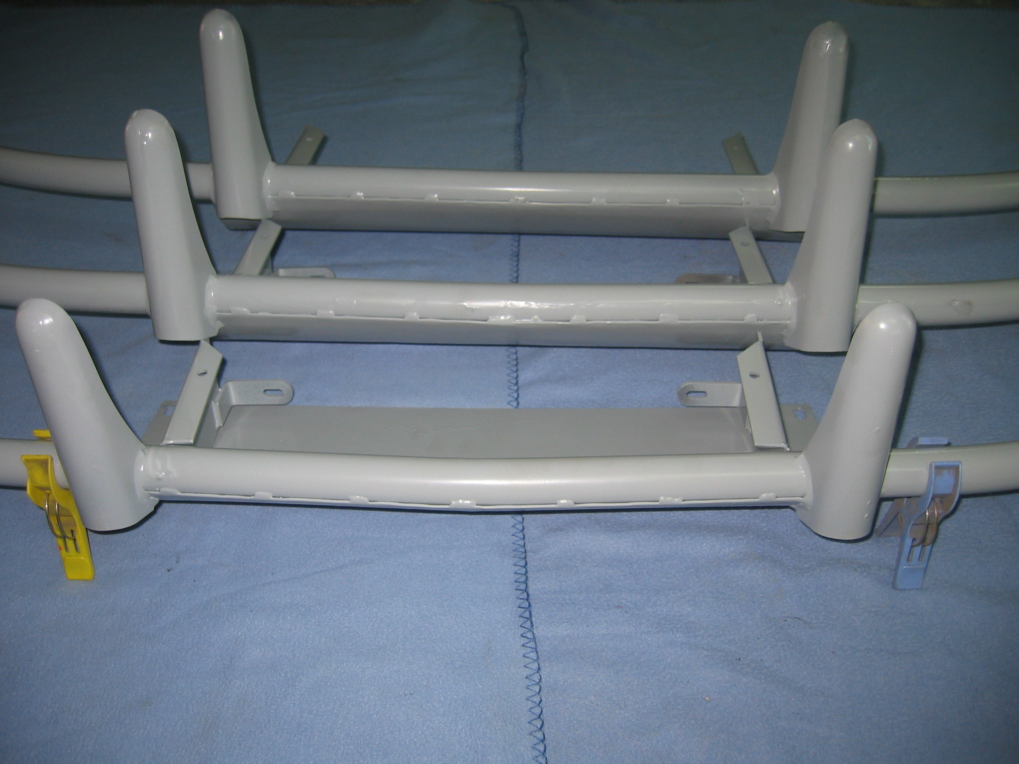

At last after having my tube bending machine for about 15 years i re produced the Original PO front bumper for 2CV Vans
This is different from the Raid / Adventure bumper
( lower, different fittings and a rolled under tray + brackets to mount to the engine cross member )
and is a direct replacement for the original only with slighter thicker materials
i will bring some to Poland
Enjoy

Re PO Bumpers Roy at ECAS will have the first 3 samples in about 2 weeks
and then a larger supply soon after that.
Pierre Focant in Belgium who is my dealer for all french speaking countries will also soon have stock
I think he sells the raid front bumper for about 150 euro plus delivery.
I will take a few to the world meeting
Pricing not yet sorted, but it will be similar to the Raid type bumper i manufacture.
By the way this part is not a made from out sourced low quality or incorrect components.
(Chinise crap)
All steel is cold rolled (not low grade black), The Over riders are pressed in house and all the welds are sand blasted before the 2 component primer is sprayed, however they will need to be flattened down before painting to colour, to be fully protected
as the primer is only for transit / storage

For the rear
i can offer you an open choice
Straight
curved ends
with a mix of hoops or the over rider like the sahara
Roy ECAS in the UK has a stock of the most common ones
but if you like a special one made up it would not be a problem,
as i have all the jigs tubes and mounts in stock
