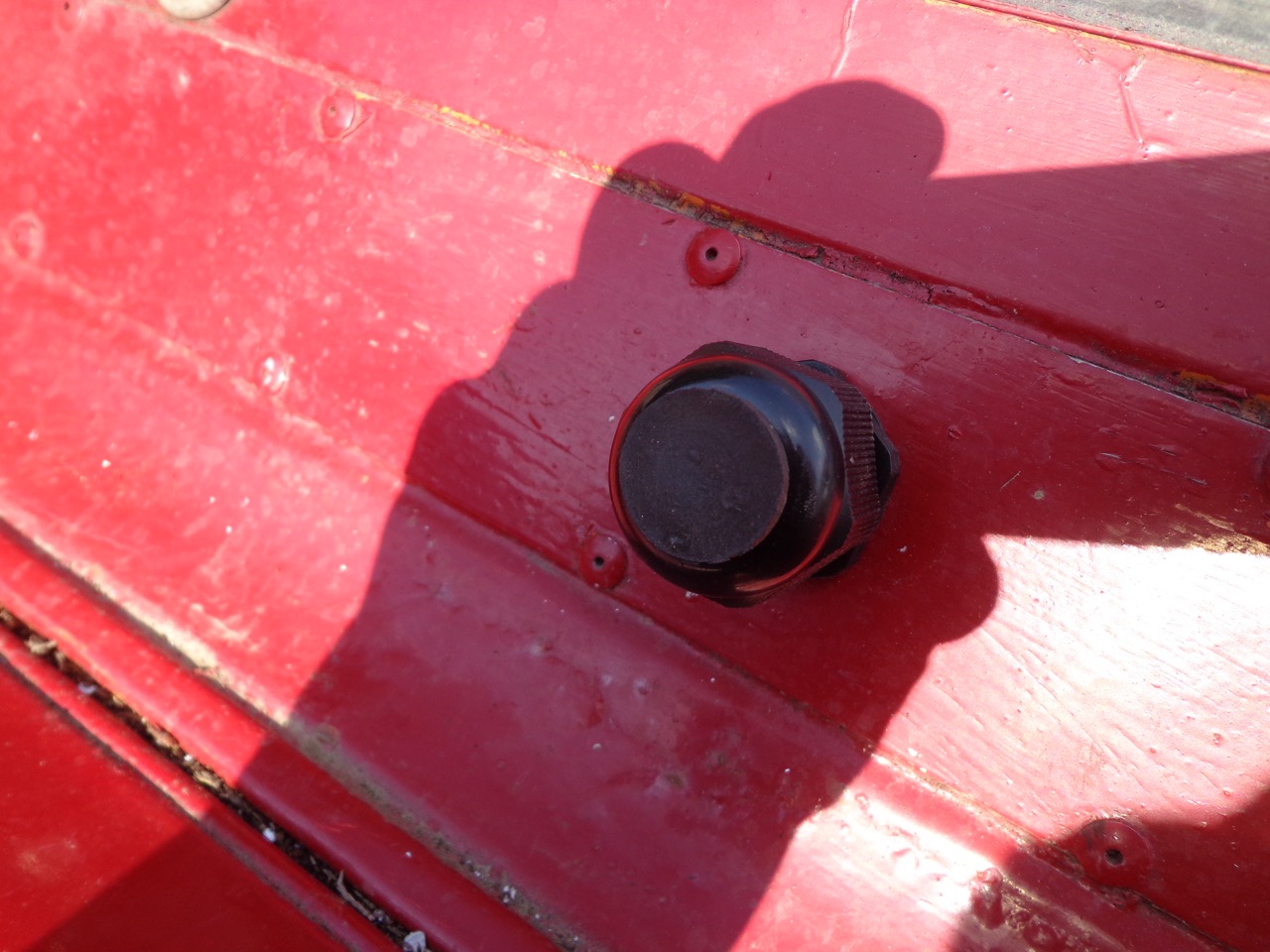

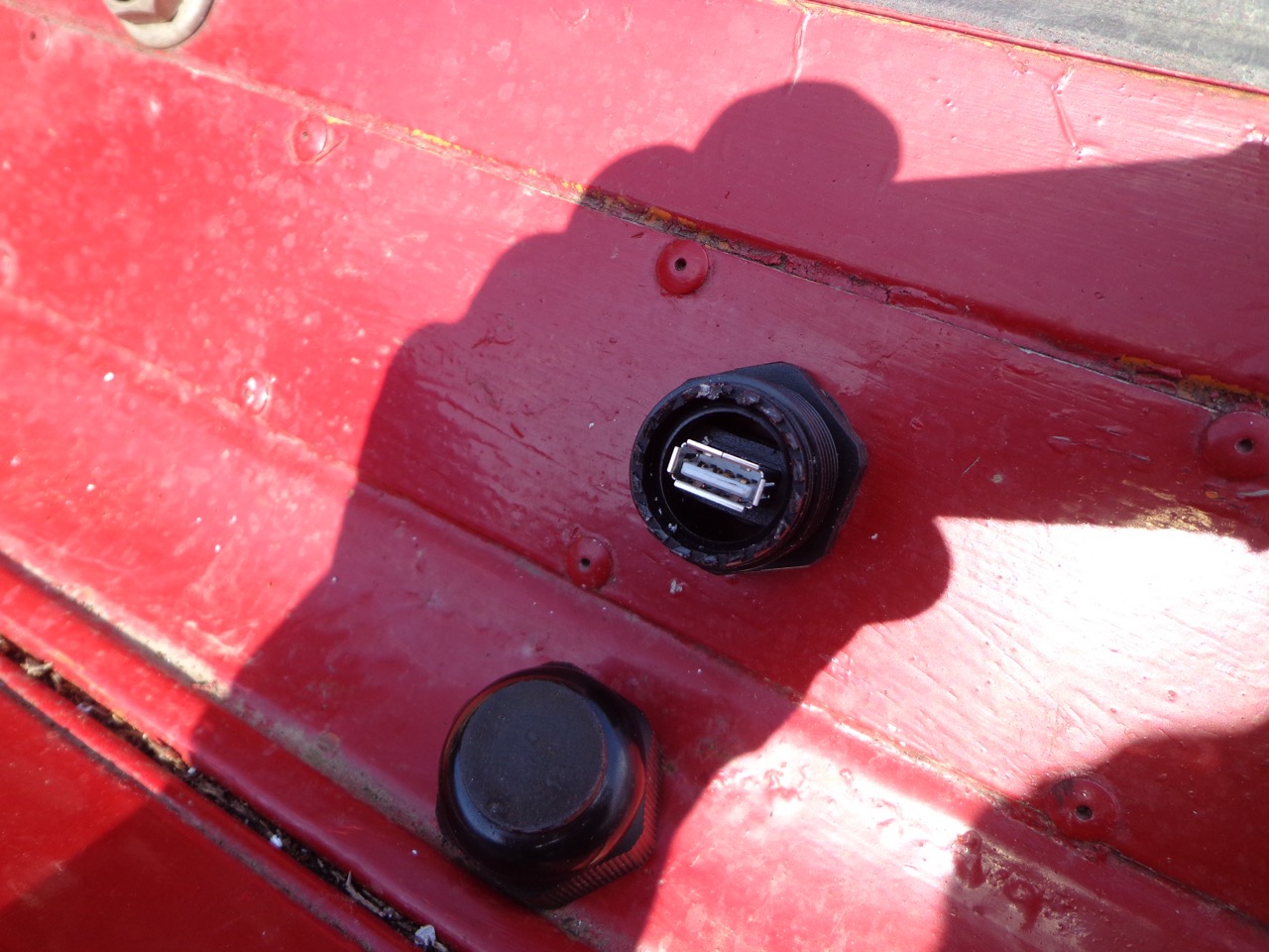

May 5th, 2015, 11:40 pm

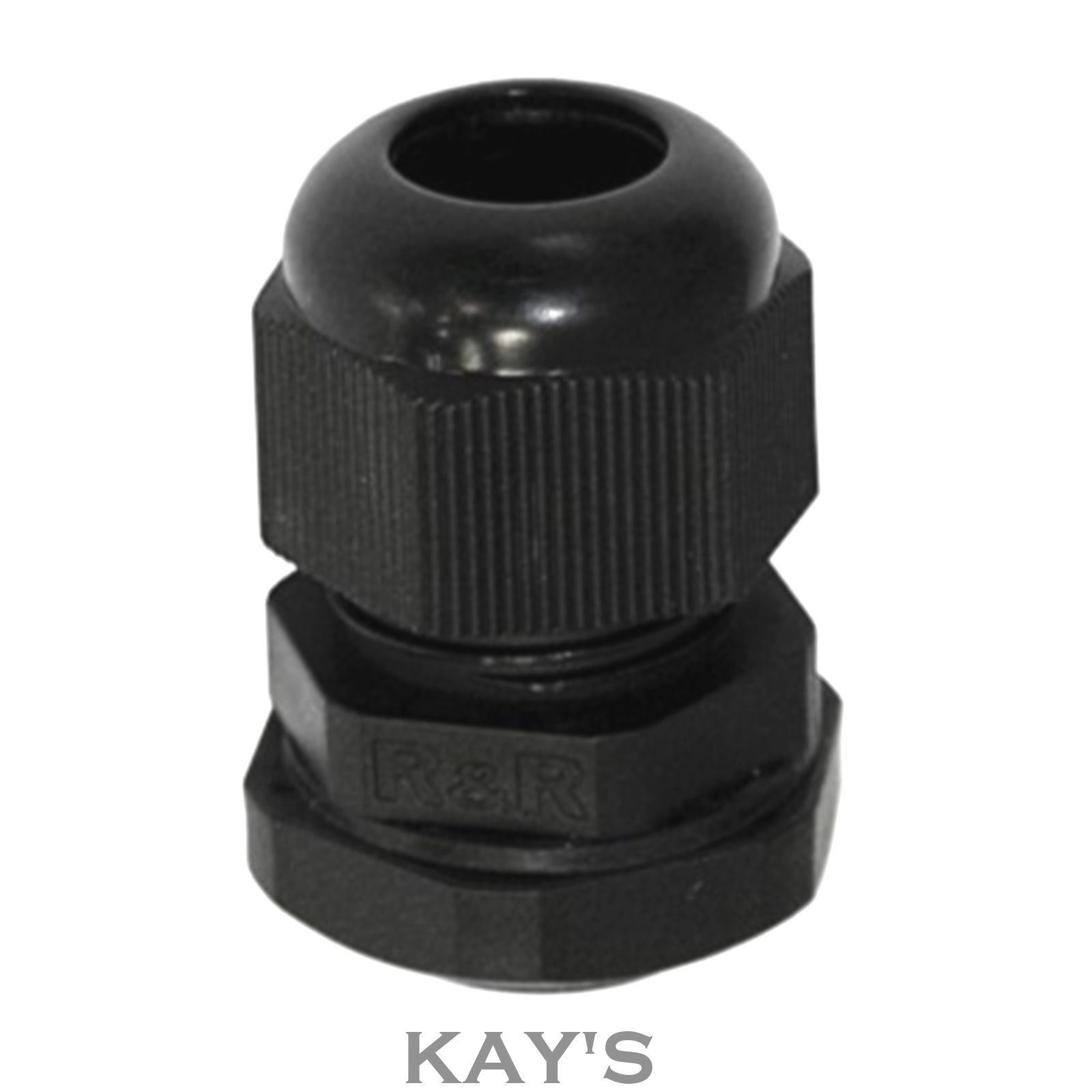

Waterproof USB Socket.
Bulkhead Gland (Size M25) £2.00
From Ebay £2.50 incl p&p
Rempve the rubber support
Blanking plug glued into the cap

May 6th, 2015, 8:09 pm
Pony wrote:
can you jump start it using that plug?
If you wait 3 days to let it charge... :? :? :?
