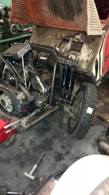

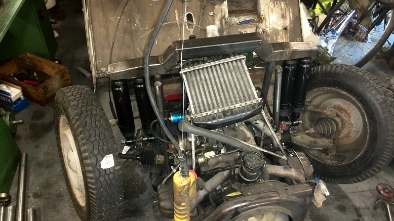

Here are some pics of the front end..
Made a bridge to host the air shocks, going over the gearlever.
