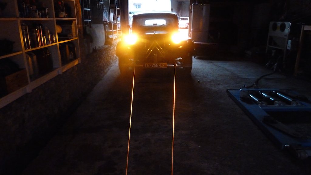

I have booked it in for its Controle Technique tomorrow morning at 09:00 so I have been busy getting it all ready. Set up the lights last night as per the book.

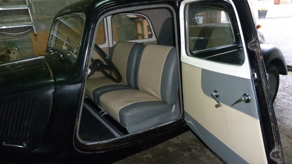

I put the door panels on and the inner window frames so this is the first time the interior has been finished. Not too happy with the fit of the door cards but I will need to remove them when my sticky back plastic arrives to weather prove the inside of the doors. The handles seem a little loose too. But a nice change to what it has been.

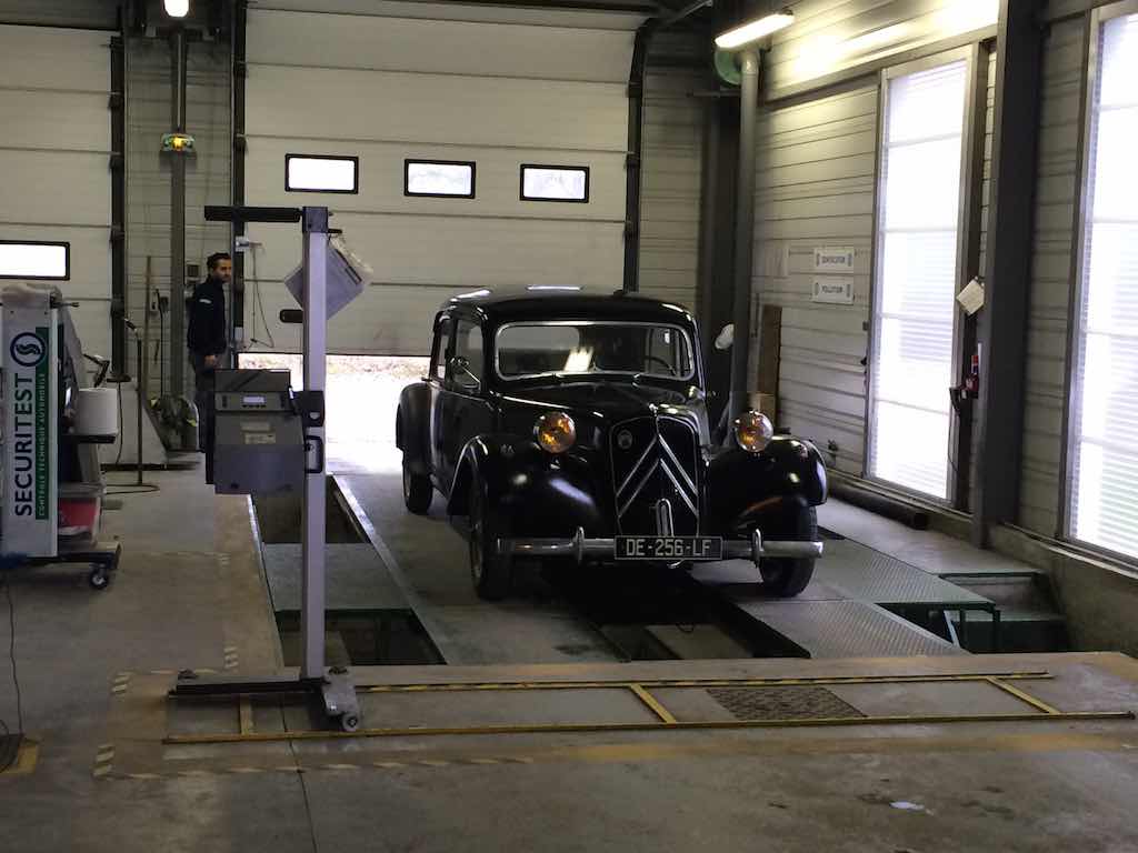

All done and dusted - the only point to fix is the front left brake not working, but the other 3 work perfectly :D
This is also the first EVER Contrôle Technique this car has ever had (other than getting the paperwork when I got him) as the test was not obligatory until 1992.
Before the test :?
During the test :? :? :?
And he passed :D :D :D :D :D
Next Contrôle Technique is in 2020 - every 5 years for a vehicle de collection :lol:

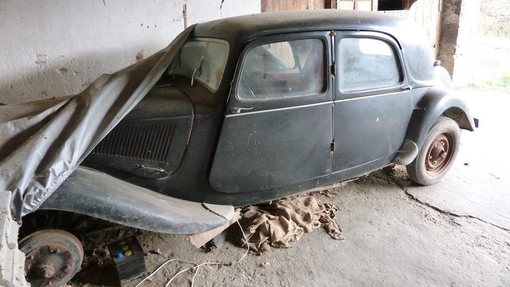

This is how I found him in November 2013 and started to work on him in March 2014 so one year to get him back on the road :shock:
