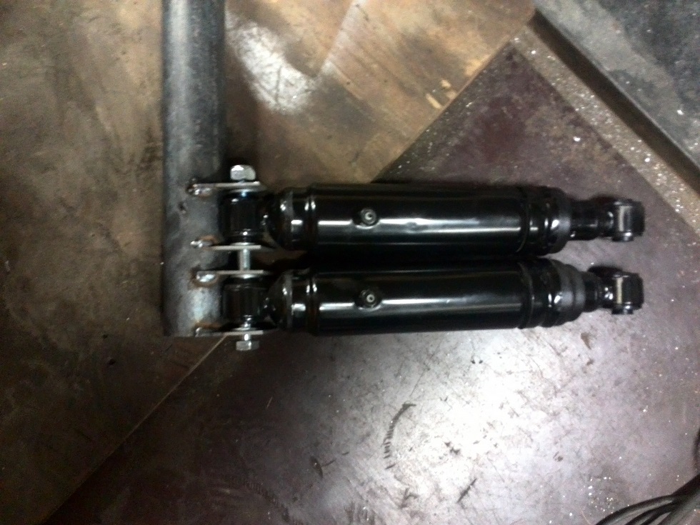

Last year around this time I bought some airshocks and today the time has come to put them under my car.....
So here we go....
First I bought some steel tube 60mmx3mm to make a cross-tube through the chassis..
Then I attached some U profil 60x60mm to host the airshocks..
Some sawing and welding and dryfitiing the shocks
Next is to put the tube through the chassis and mount the other two 60x60 U-profile..
As you can see the mounting eyes at the wheelarm needs to be on top of the axle, so lets modify the arms..
At last the shocks can be mounted..
