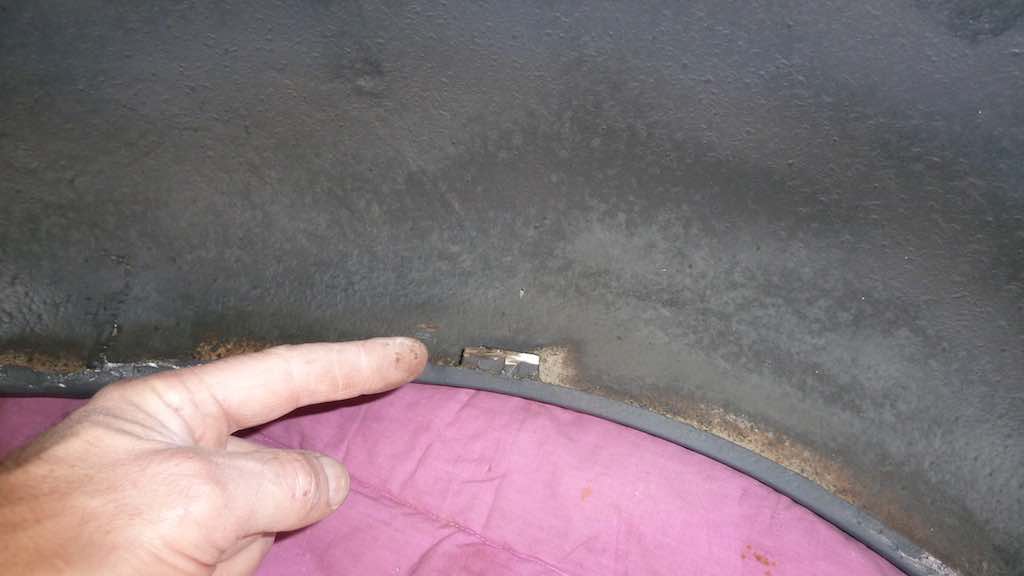

I did have to repair the fixing bracket that fixes to the support bar. One had snapped off when I got the car :(
So a quick template and I cut out a new piece
And then welded it on in place, painted it with chip seal like the rest of the underside of the wing and voila!! :D

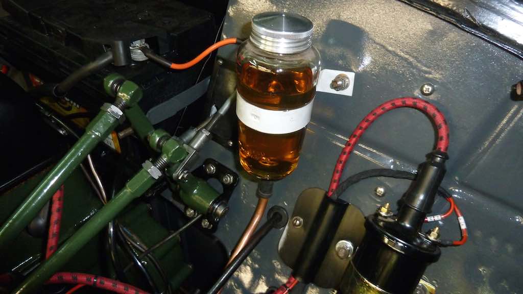

Then onto the brakes. Rear left drum had stuck on and it took an age to remove it. The forward shoe had stuck, must have been when I was fitting the handbrake mechanism. Re centred the shoes and rebuilt the hub.
Then onto filling and bleeding - all went OK with a few leaks but it made me go through the whole system tightening and checking. Brakes were sold and worked great (no road test yet though ;) ) Filled up the glass jar which is the first time it has had fluid in it.
But just as I was about to finish and turn the lights off, I noticed the level had dropped by 1 cm. Checked under the car and there was a puddle under the master cylinder. Whipped off the panel and could see the fluid leaking from the push rod of the master cylinder. If you remember I was worried about the refit kit I was given and the type of seal. It did not match exactly the original but with a lot of these replacement items that is quite common. So I have ordered a complete Master Cylinder to make sure it will be fine.

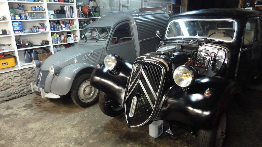

I then started with the wings - the right wing is now secure and went on relatively easy. Fits very well seeing as it was a pile of rust and dented metal when I took it off. I also fitted the indicator and headlight unit - I just love those headlights :D

So on with the jobs I can do - on with the other wing
All the lights connected and tested, although they will need aligning when the car finally is on the ground.
And finished for the night with half the front grill bolted in (a lot more difficult now the wings are on)
