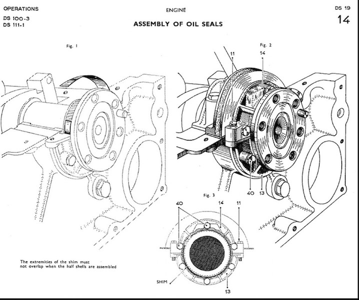

OK - so I have had my problem explained by Peter Larson of CTA Services. It seems that I have an ID oil baffle fitted and this unit does not take the graphite cord. Hence the reluctance of it to fit and subsequently snapping the lower unit.
My car came off the line in the 12th April 1955 and stood in a barn since 1972. I have had a few explanations as to why my bottom end is part 11D (DS) and part Perfo (Original Traction) as the engines changed to D from May '55. It may have been built using new parts off the shelf when they ran out of Perfo parts - I tend to agree as there is no evidence that this engine had been removed before. But it does cause me problems specially as I am new to all of this and do not know what to look out for.
Here is what it is supposed to look like.
I really wish I had known as this would have worked out a really easy job :(
I am going to have a go at repairing my unit and see how it goes.

Right, this is the baffle unit I have and my engine is a Perfo engine but from the 12th April'55 - so citroen did mix up the parts towards the end of the Perfo it seems.The previous owner did not do any work on the car from 1967 so if the original owner had any repairs down it was in the first 12 years of its life. Very strange :shock:
I was sent this through by Peter Larsen of CTA explaining the procedure on fitting - if only I knew before it would have been finished - but you have to learn somewhere, right :)
I am going to try and get it repaired as I cannot find a replacement anywhere at present - hopefully a few phone calls tomorrow might find something but the per equivalent is in excess of €100 so maybe 30mins in a weld shop might be cheaper.

Needs TIG and gas for Al

On the oil baffle issue I have a couple of options - A citroen guy up in Scotland has found one that I can have but it means breaking an engine for it. So tomorrow I will look for a TIG welder and see if I can repair it. If I can't then I may be send it over to the UK to you Pete :)
The procedure I have now will help me install it (I will make the 0.1mm shim by cutting up a coke can :D )

I have given the crankshaft seal to a local welder who will hopefully fix it - if it is crap then I will have to go for a new one.
it has caused quite a lot of confusion and explanation on my part to try and convince the Traction guys that I have this certain Crankshaft in the is engine. I even emailed the Citroen Conservatoire to ask them if this could have been done in the factory as my car was one of the last to be used with Perfo - they just came out with dates and said mine should be per (probably not opening themselves up to the fact they used whatever parts they had to hand at the end of the line.... or more probable, the archivist would not know anyway :? )
