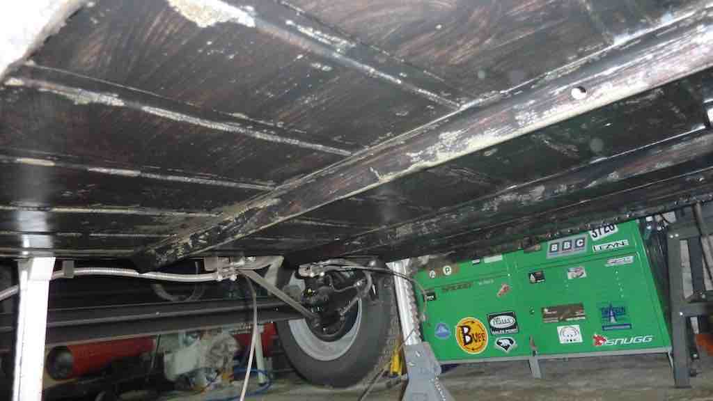

I think I have finally finished all the really dirty jobs. I raised the car up on axle stands so I could get underneath and get all the crap off the bottom of the floor pan. Also so I could finish off the welding on the replacement front floor panel.
Lots of dust but now I can clean the garage and hopefully it will stay a little more dust free :?
I slapped a load of rust converter paint (Restom) on the panels and left it to dry.

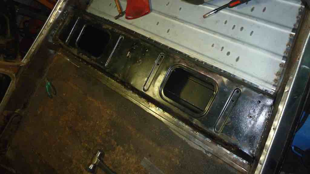

I joined the V sections under the floor. They were slightly off but managed to create a small filler panel. Welded it all up and covered all the seams with a polyurethane seam sealant.

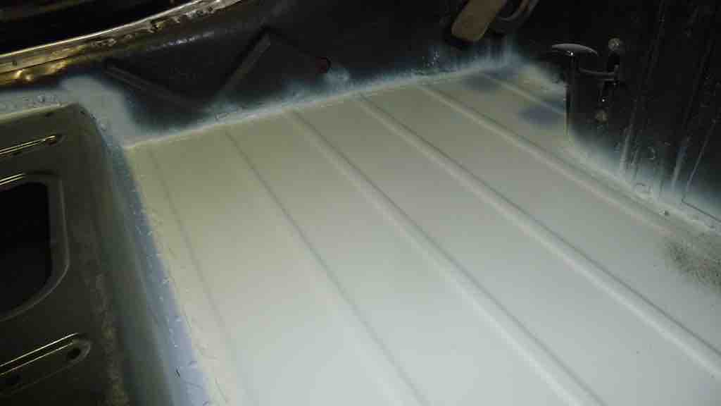

Inside I rust protected, primered and painted the inner floor that is covered with the seat cross member. I also seam sealed the welds and edges before putting the cross member back on.

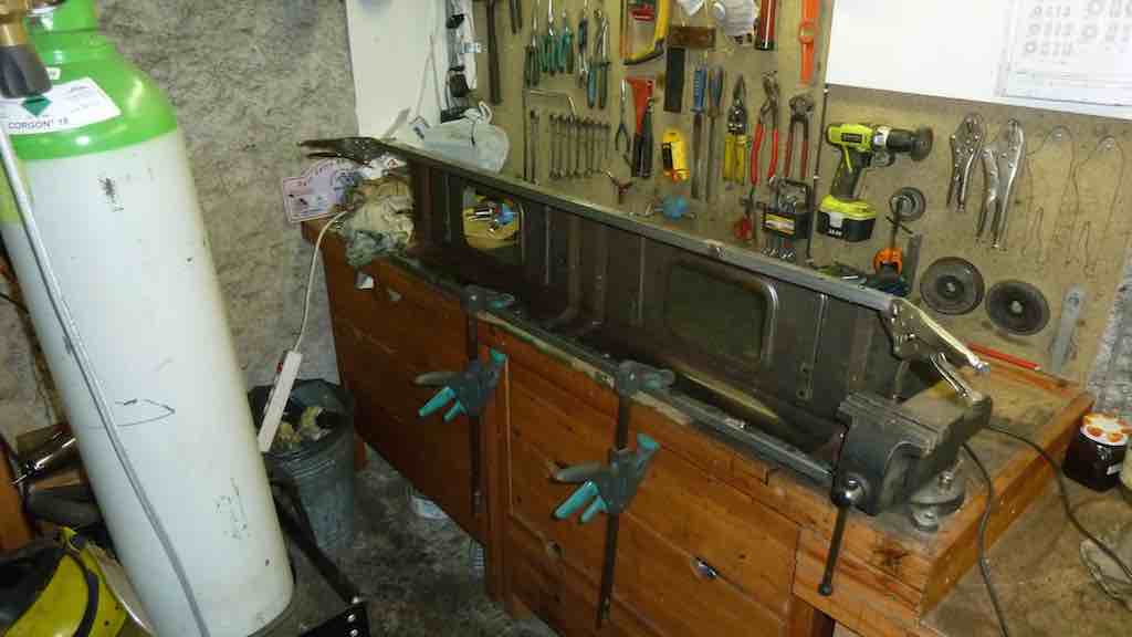

So the next job was repairing the seat cross member. I had to remove this to get to the floor panel. So I had to cut the flanges off and then hammer chisel the flange and spot welds from the floor. So will a little bit of angle I made up some new flanges and after lots of marking up (and several failed spot weld attempts..... all good practise :D ) I fitted it all on the bench.
It fitted straight in and I spot welded (punch hole then enlarged to 8mm and used a spiral movement on the weld) the cross member to the floor and also to the sills of the body. It seems pretty firm and inspection underneath showed the penetration of weld so I am happy now and getting a little more confident with this welding stuff ;)

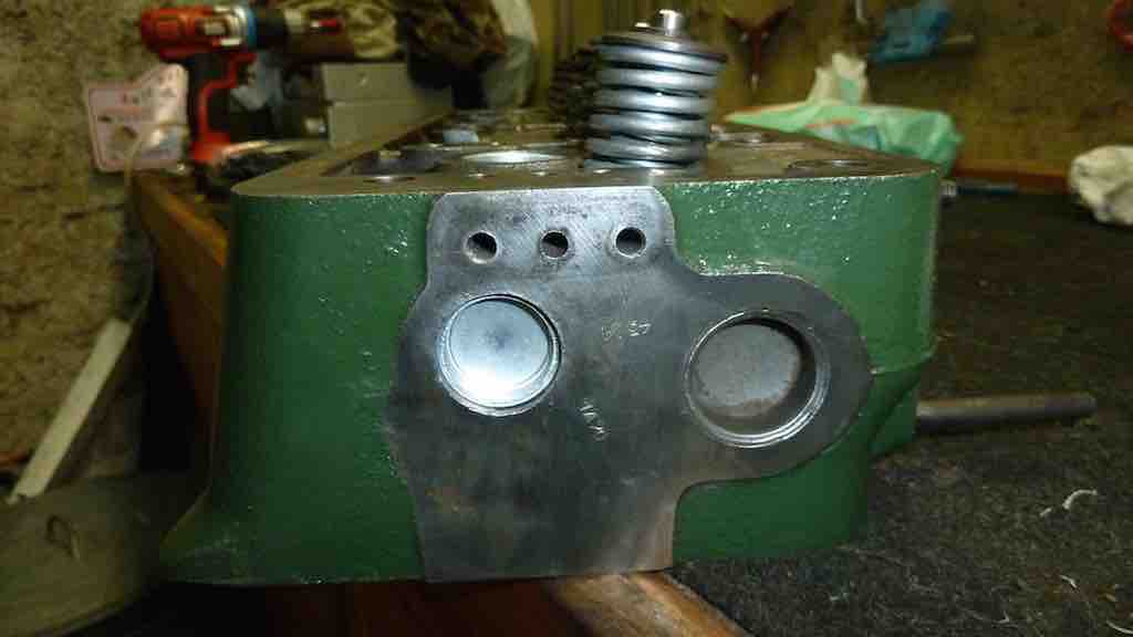

So now I need to prepare the head. My new coolant tube arrived along with new core plugs. So with a little more cleaning I fitted the pip easily pointed the holes downwards and then sealing (glueing) each end with ultra blue. I also flared the end of the pipe at the water pump end, hoping it won't move too much.

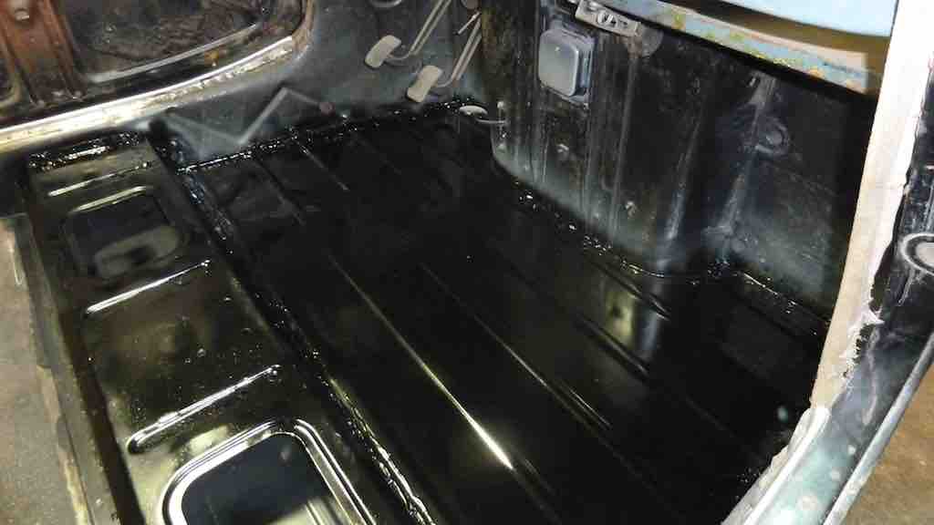

And of course in between these jobs I am finishing off the painted of the floor panel I replaced as well as getting the underneath finished off.
So after sealing all the seams and the edges with polyurethane weld seal I painted it all with rust eater and then primer.
Then a nice top coat of satin black just to make it tidy and for the underlay and carpet to sit on :) It is starting to look like a car again in side.

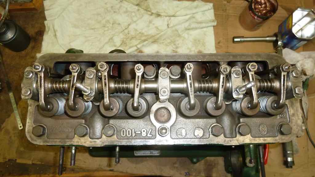

And prepared the head for docking :D Nice new gaskets and placed the push rods in place.
December 17th, 2014, 7:17 pm
On with the rocker shaft all cleaned up. Took some time cleaning out the shaft and making sure all the oil passages were good - I have read a lot on this subject lately. :?
Looking more like an engine - the cam shaft pulley is fitted and the valves seem to be going up and down in some sort of sequence.
