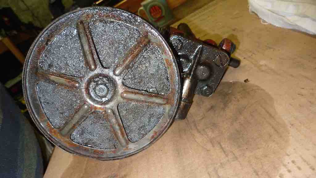

Onto my oil pump - now this was disgusting as it had sat in a mixture of oil and water for the past 46 years. Hence the filter mesh is rusted out and the upper filter hood and upper cover are corroded so have ordered new. The rest of the pump looks in good order so I stripped cleaned and rebuilt with new gaskets.

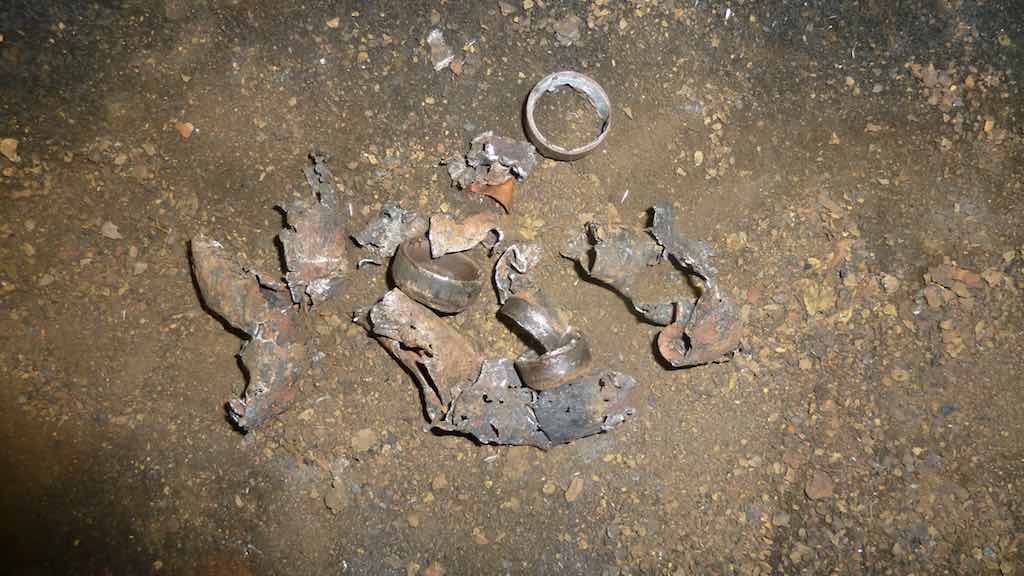

Onto removing the rusty old coolant tube inside the head. What a ridiculous design this is. A job I was not looking forward to at all.
This is the tube that runs from end to end within the head and distributes coolant through 4 little holes. One end is open to the water pump and the other butts up against a core plug. So first things first was removing the core plug. I watched a dozen tutorials on You Tube showing how easy it was. All of them were on big US engines where the core plugs are the size of dinner plates. Mine ate 25mm and 30mm. It took some hammering, heat and a lot of swearing but I got the end one out.
I then had to take the top core plug out to dismantle bit by bit the rusted tube. I used a metal down rod to tap out the remnants of the tube and pulled the pieces out where I could with pliers. What a crappy job but all done with 4 core plugs to replace.

Here is the tube and the core plugs, the way they ended up :o
