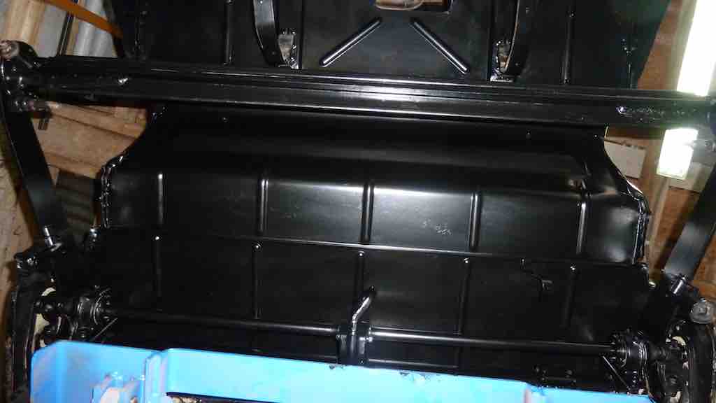

I have finally got the dirtiest job out of the way. The cleaning, rust treatment and painting of the rear underside of the car. This was disgusting covered in years of mud and crap. I wired wheeled the lot with the rear suspension system still in place as I didn't want to take this out for now, although it made the job ten times harder and there just a few places I need to get too once the car is off the lift.
But I think I am getting there and it seems the thick layer of mud has preserved the steel as new :D with absolutely now rust at all.

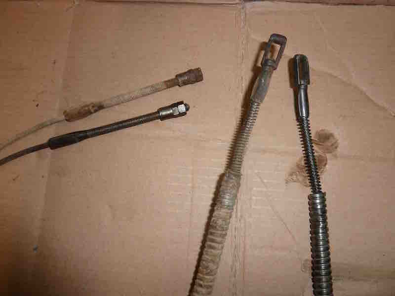

Installed the handbrake cables but not before giving them a good cleaning, service and greasing. These original parts to stand the test of time so no need to buy all new parts with this renovation.

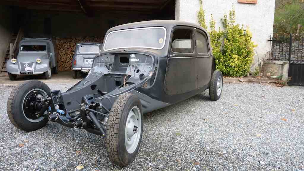

I managed to get the car back on its wheels, first time since early this year. The whole suspension and drive chain is complete at last.
Then out into the open air a little dusty
But after a bit of a wipe down it is shiny again........ well until it all dried off and now it is back to dull black again :D
