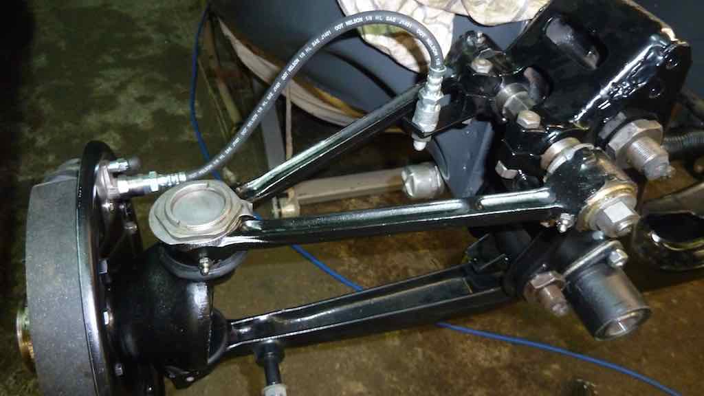

Bit of a nightmare today. I started putting the upper swing arms back on. The to ball joints went in OK (well I say OK, they went in.... it has been a while since I took them out :shock: ). But I was having a right job with the bottom ball joints. There was a lot of play and I mean a lot of play. Until I realised I was missing the top bearing race which I now realise I had left in the lower swing arms when I did the exchange with Classic Automobile Services in Holland. Sent them an email and they are posting them back (after telling me they were in a bit of a state :( ).
I carried on an installed the brake backplates and the flexi hoses just so the day was successful.

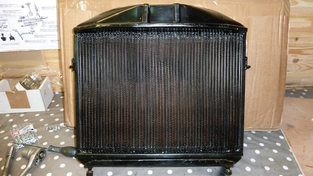

My reconditioned radiator came back today, only waited since April.... lucky I am in no rush for it. I have emailed them though as the top cap is missing. :(
Started on the brake lines too, got the engine bay finished and now waiting until I have done the floor and the rear axle for the rest. Now I know the parts for the master cylinder, I got that back together and installed.

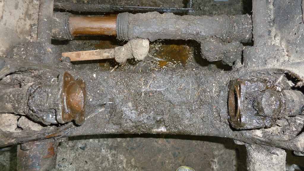

So I have made the decision to renew the floor up front. I ordered it from José Franssen of Belgium today and it is on its way. So to carry on with the dirty jobs first I stripped out the cross member. I started drilling out the spot welds but in the end it was easy to cut it out and I will put it back in with some angled steel., Will make it slightly stronger too, I hope.
I cleaned up the floor - it it messy with thick tar under the carpets. I think I will leave the rear area as it has protected the metal under the cross member very well.
The new floor is 69.5 cm from the front so the cross member will sit over the join which will make it look tidier and gives me a little satisfaction that I took the decision to take out the cross member as I only looked up the size afterwards. The rusty floor goes to 65cm so I will have 4.5cm of spare.

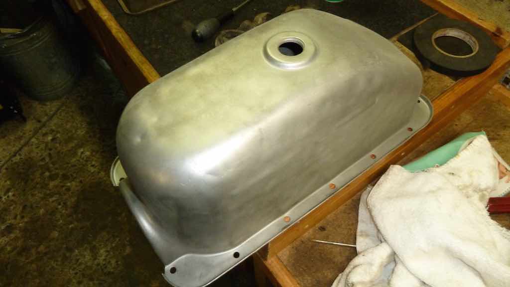

The sump came up good and it seems a shame to have to paint it :D

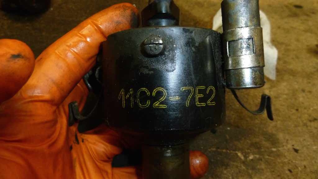

In between cleaning I have to keep myself saine so I am starting on the refurb of the smaller parts to keep on top of it. So here goes with the distributor :shock:
I will first get everything working with the standard distributor then try out the 1-2-spark electronic ignition. Just a silly questions, will I need to change out the condensater for a 12 volt version do condensaters do both 6 and 12 volts :? :?:
