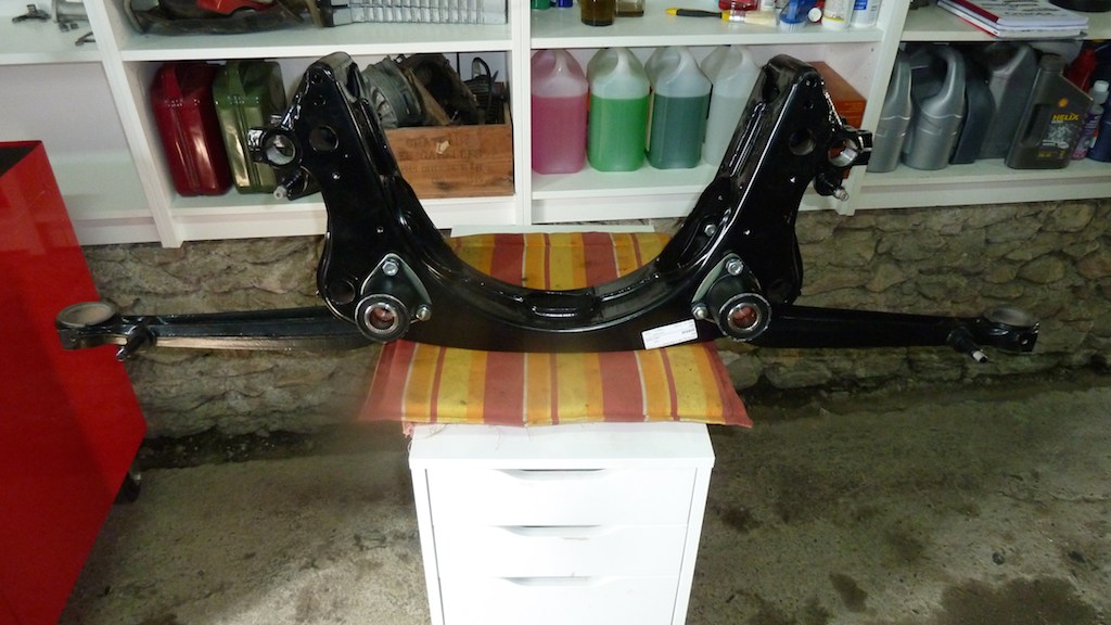

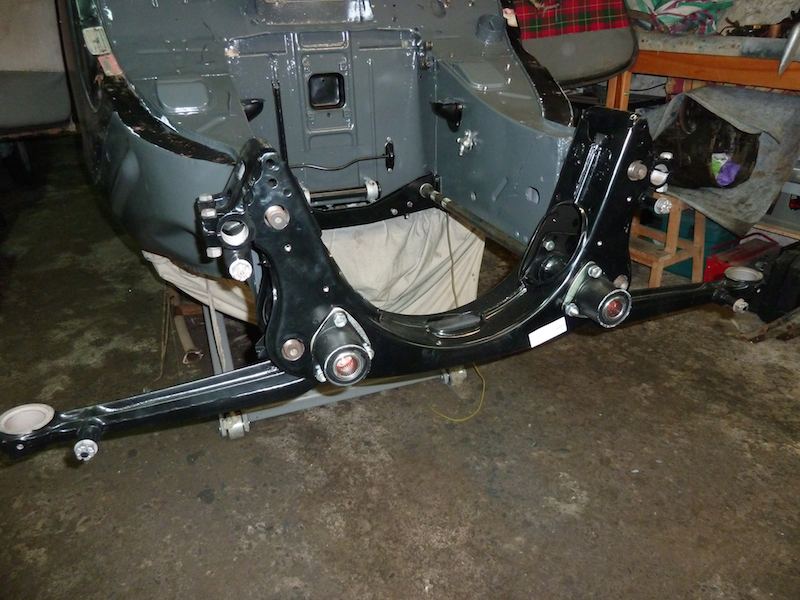

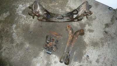

When I removed the silent blocs from the front cradle, I managed to damage the cradle a little using the press. It was repairable but when looking through the costs to sandblast and paint and then replace all 4 silent blocs it came to around €650.
A complete replacement cradle with silent blocs installed plus arms was on €700. So no brainer, I ordered it and received it yesterday. I just packed up all my old parts to be shipped to Classic Automobile Services in Holland.
Lazy exchange :lol:

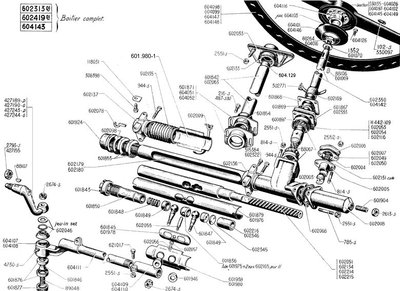

I cannot tell from the diagram what is supposed to unscrew from what :?: :?:

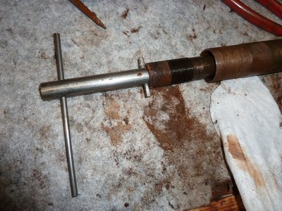

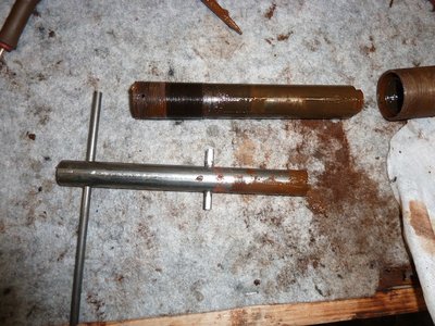

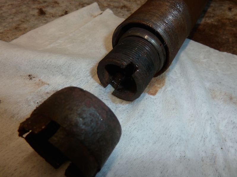

When it says "Remove split pin, unscrew slotted nut forming guide ball (done) and disengage retaining tube from ball pin seating by using spanner 1976-T "
What is involved when it say disengage retaining tube? Does that mean unscrew? Left or right or just wiggle?
The one tool I do not have is the 1976-T but I think I can manufacture one but still don't know what I need to do with it :(
October 10th, 2014, 8:55 am
Posts: 761
Location: Kingswood, S.Glos.

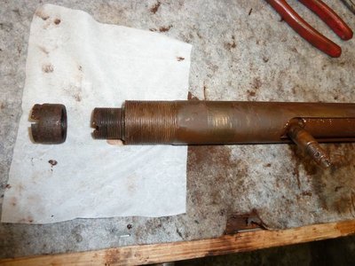

From the drawing it looks as though you have to unscrew. It looks very difficult without the right tool. The smaller 'dog' stops the rack turning whilst the bigger 'dog' unscrews the retaining ring.
Edit: Just looked at your photos. Looks like you've already undone that part.
And looking at the exploded diagram it looks like you unscrew and pull out part 601850 to enable the two ball joints to be released by jiggling them along the rack to the keyhole release points.
John Jordan
October 10th, 2014, 9:21 am
It comes down to the right tools for the right job..... for sure :D
I made up a mini 1976-T spanner from a bit of 20mm tubing and 6mm rod. I pushed it in and wiggled a little bit but nothing so I went for the screw. After a bit of effort it loosened and it came out no problem at all. phew :P

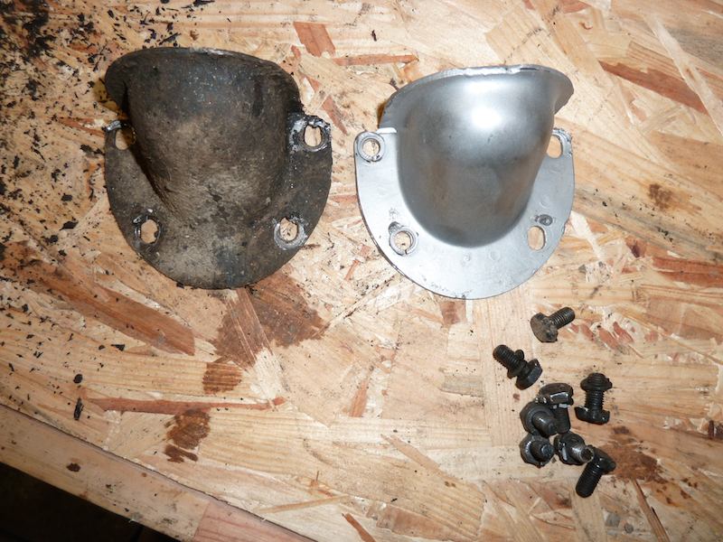

I have finished painting the engine bay (and under the wings just to protect the bare metal as it had pealed with rust) which is not too bad for an amateur attempt. I had to sand it down a few times but it will mostly be covered up with engine parts (I hope :lol: )

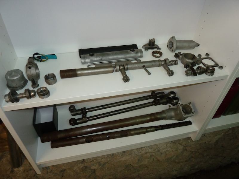

I dismantled the steering rack which was a task, mainly due to the hardened grease that had packed out the springs and washers. Some of the individual parts are quite pitted but I will take the top tip and turn the ball joint by 90 degrees to allow the new surface to be used. I am thinking with the cleaning and new grease they will be good for another few years. I have ordered new dust covers, gaiters, gaskets and balljoint dust covers.
I am concentrating on everything that needs to be fitted into the engine bay before the engine goes in. This frees up my bench space so I can then start on the engine rebuild.

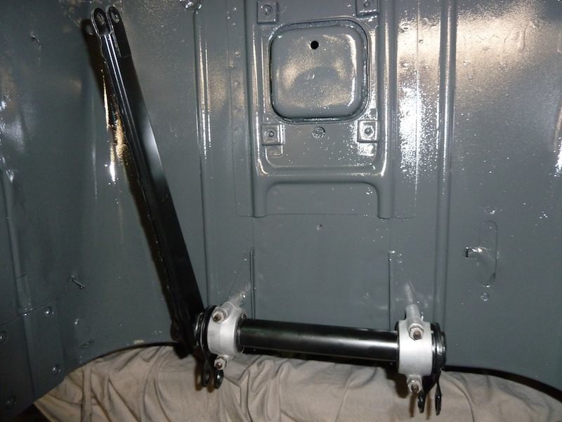

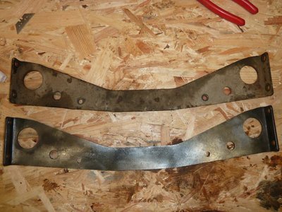

So next on the list are the torsion bar mounts, engine mounts and the accelerator mechanism.

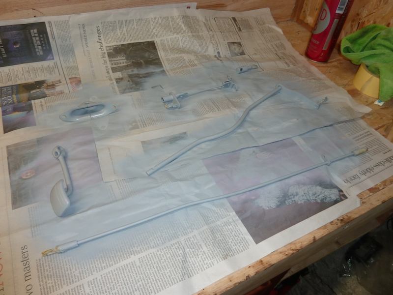

I am painting and refitting as I go which is quite satisfying as at least I can see some progress instead of shelves full of dirty old parts :shock:
And I finally got the first part back on the car - the handbrake mechanism :D :D

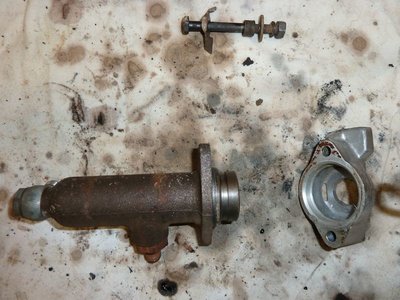

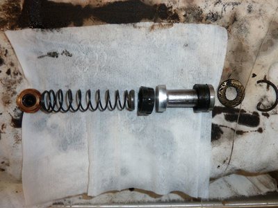

More done this evening - stripped down the master cylinder and cleaned all the parts. I have ordered the refurb kit which will come with a new resevoir bottle and copper piping kit so I will do the complete braking system all at the same time.

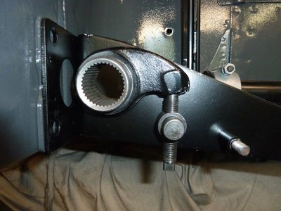

I re-installed the torsion bar adjuster mechanism after a lot of cleaning, this was just covered in tar, mud and crap and was unrecognisable when I took it apart.
Bit of fettling to try and save the paint I got the face plate on and all is secure. I also installed the gas pedal mechanism too so all at the rear is done (except the brake system)

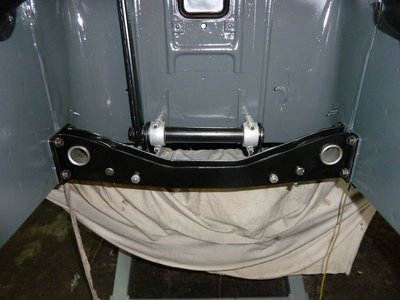

I offered up the the front suspension system and put in a torsion bar to see if it all fitted. It is starting to look like a car again....well ok, a skeleton of a car :lol:
I will read the section on installing the torsion bars tonight ready to get them in tomorrow. And then it is full on with the front suspension system and hubs.
