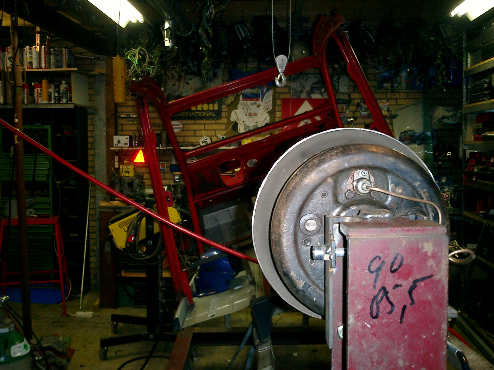

Think I'm going to make me a rotisserie type jig thing, so I can work on the van's underside. Anyone on here ever made one, or got designs for one?
You just convert this:::
to this:.....
Just take a back axle from a 2cv and you've got the hardest thing, made well you can even brake it in every position......
June 9th, 2014, 9:28 am
Post Re: 1976 AZU250
Nice!
How and where do you attach it to the bodyshell?
June 9th, 2014, 5:50 pm
First of all this isn.t mine and it looks as if there is a complete chassis underneath welded to the front and back post....
June 9th, 2014, 8:36 pm
It must be nice to be able to roll it back and forth to work on both sides of the same piece, but is it really vital? With a bit of planning you could do all the top pieces, then get some mates around to tip the shell onto it's side or roof so you can do underneath
