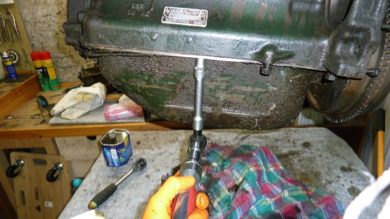

This engine is so heavy I cannot lift it, so had to make a small bracket and use the engine hoist to lift it and undo the bolts to the sump cover.
Managed to get them all undone with out bother. The sump cover has two metal surrounds to clamp the cover to the block, under the crap they were nicely painted in original green.

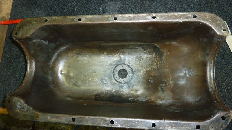

But after scooping it all out and cleaning it looks a bit better. There are some tiny little fissures (holes) in the base but they do not go through. Hoping these will be OK as the cover is pretty thick and sturdy.

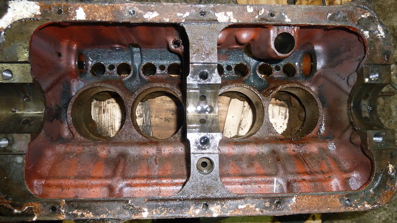

There is a bit of surface rust on everything but when I undid the piston rod the white metal bearings were shiny and the surface was smooth, plenty of depth left of them too. These are expensive to replace so I may have got away with it.
Looks like all the pistons are rusted stuck in the sleeves though :(

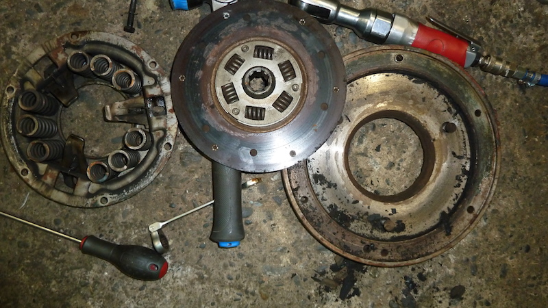

I had to try and reduce the weight of this monster so I could work on it.
So off came the clutch, in pieces, which I then spent a good 30 mins putting it all back together, but at least now I know how it works :lol:
I am hoping to get this re-surfaced along with my brake shoes.

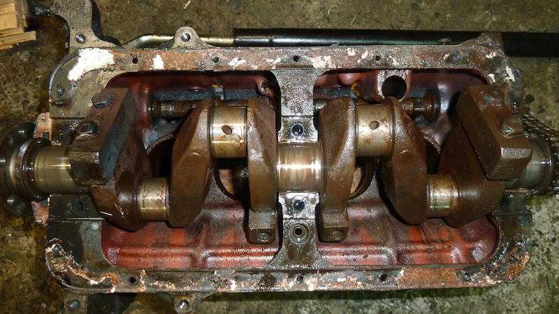

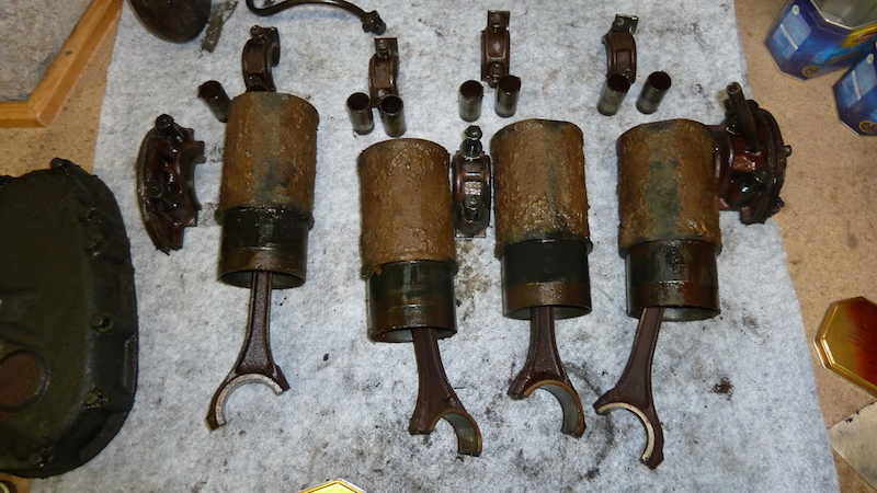

So off with the piston arm rear bracket (I need to learn the proper terms) and I then knocked the pistons downwards which in turn took out the whole piston sleeve. I think the bearings are fine, no scoring just a few stains - anyone able to comment on this :?: :?:
All the pistons and sleeves out now

Tripyrenees wrote:
So off with the piston arm rear bracket (I need to learn the proper terms)........
Big End bearing caps :D

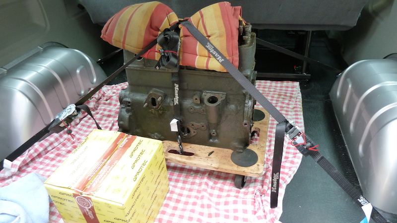

Bought a piston kit from the Bourse d'Exchange in Tarbes this past weekend. they had every part I needed but I had to be disciplined as I am not ready for 99% of them. Great Bourse though, probably the best in the area.
Taking the engine off to Toulouse for it to be cleaned , flattened and hopefully have unleaded valve seats put in, plus have the piston sleeves installed.
Some before shots before going. :D
