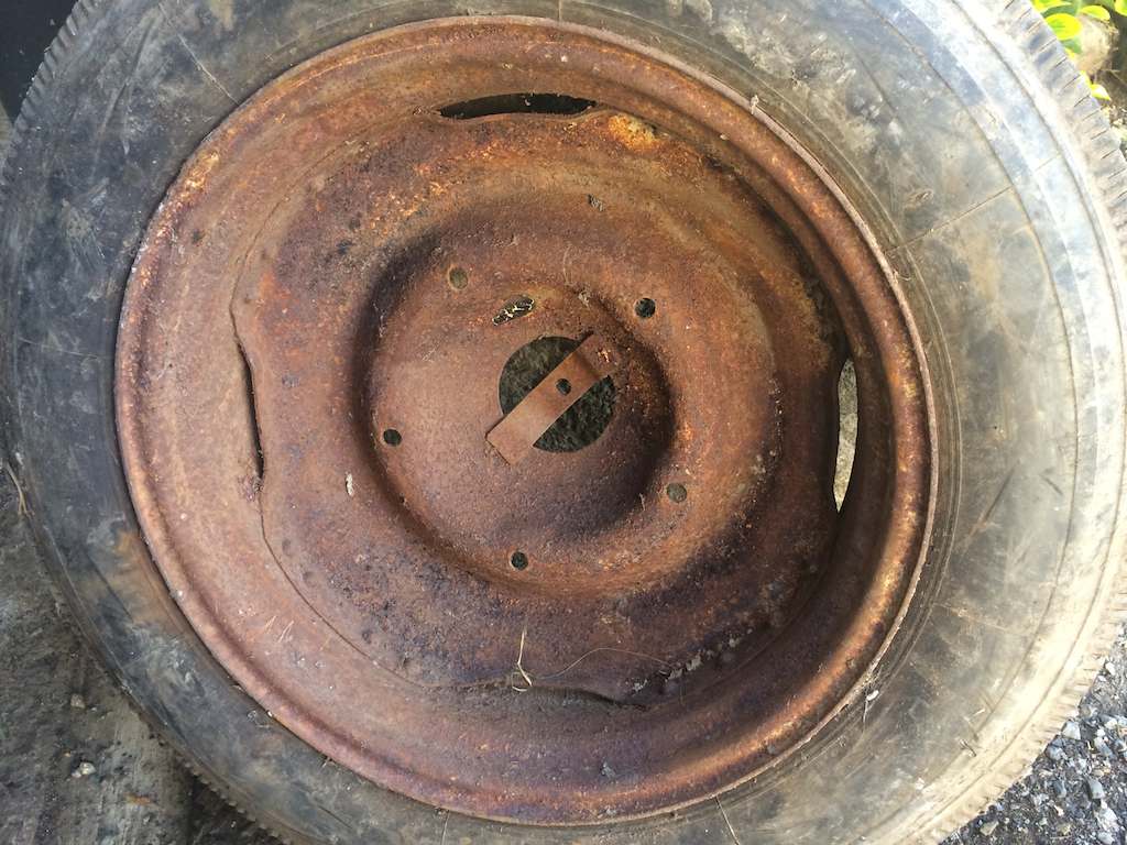

Had the wheels sandblasted yesterday. They are quite pitted so will need a lot of paint.
I left them with the paint shop to be sprayed, a bit more expensive than I wanted but they are in a worse state than I thought too.
Before
After

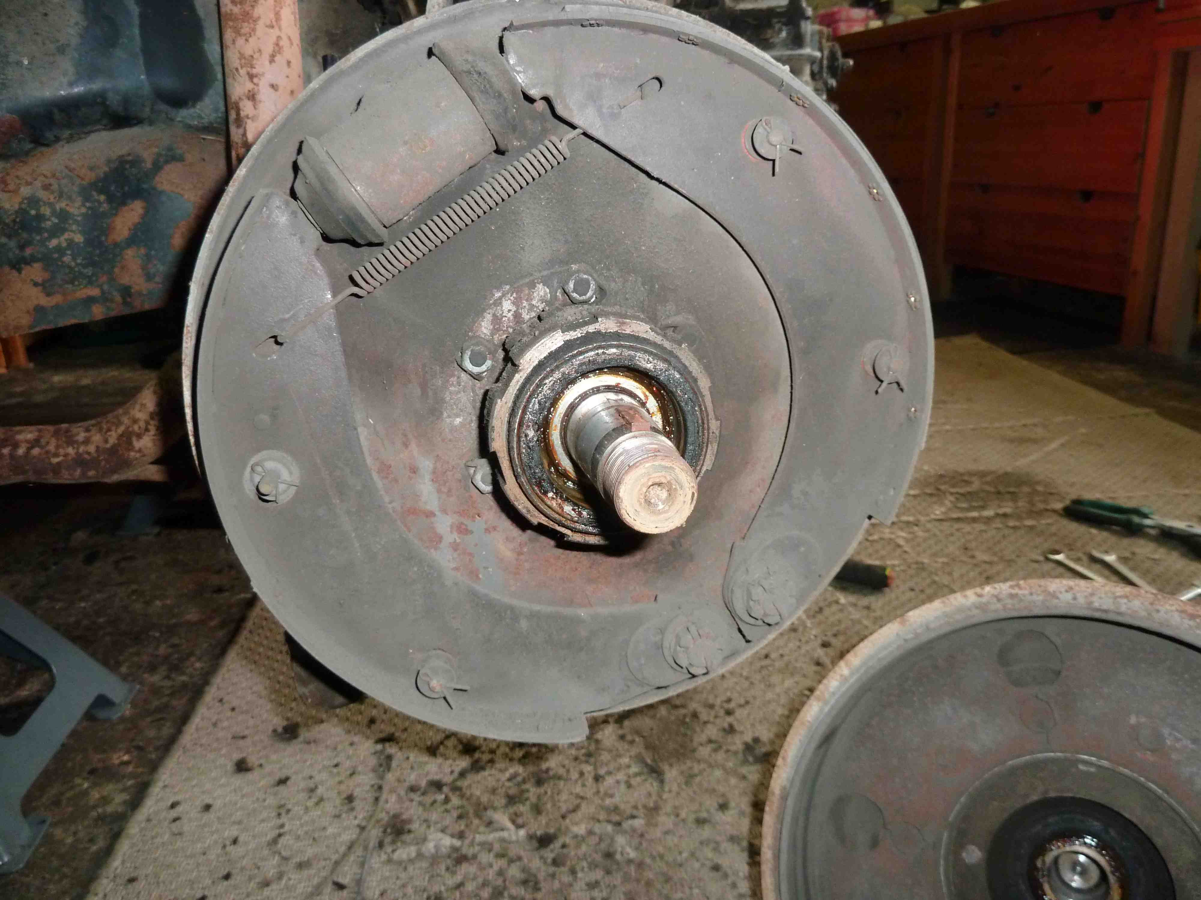

I have been watching some tutorials on You Tube (Le Mecano Du Dimanche) for various jobs on the Traction. I am now thinking he makes it look bloody difficult. :o :o
I prepared myself for the worse taking the castle nut off the front drive shaft / drum. Made up the various supports and tools and put a 2 metre bar on the ring spanner, went to pull down and "slip" it just un wound without a hitch.
It was then the task of removing the drum which you need a special removal tool. I managed to find one on Ebay and won it for half the going price and it arrived yesterday. So put it on (after going out to buy a suitable size spanner - everything seems to be getting larger).
Put it on and clunk, hub drops off - :D Very pleased with myself.
The previous owner told me that he would drive this up and down to the ski station close by with 11 people in it. Well the brake shoes are down to the rivets and the rivets have made two nice tracks in the drum surface. So it will need to be skimmed a little. But braking system looks to be serviceable - so I will get the slave kits and get them rebuilt. I will also get the shoes relined too as less them a mm is not too good :roll:
