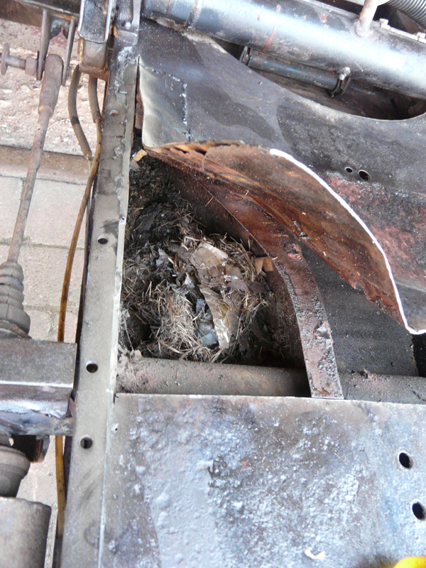

Then I cleaned the chassis thoroughly and took a good look at everything. It's looking remarkably good, on the whole, although the skin on top of the chassis near the front was looking a little rough, and the previous owner had done what looked like a suspiciously half-hearted patch weld on a couple of areas. After a few minutes of procrastination and a strong cup of coffee, I decided to rev up the angle grinder with a new cutting disc attached. 30 seconds later my decision was vindicated:
Five minutes later I'd demolished Mr Mouse's abode and cut out the section of poor-condition skin, and cleaned up the cavity:
As you can see I also cut off the rotten bits of lip on either side. I've welded neat little replacement pieces back on now, and put a couple of tiny patches back on the internal curved pieces (which got holed when I bashed out the spot welds that held it to the floor). It's all looking nice and clean now, and the chassis is generally in very good condition.

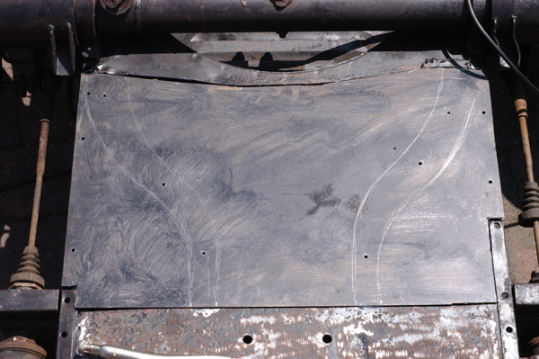

Started by prepping the area and cutting out the new panel:
Then I butt-welded it in and ground back the welds:
