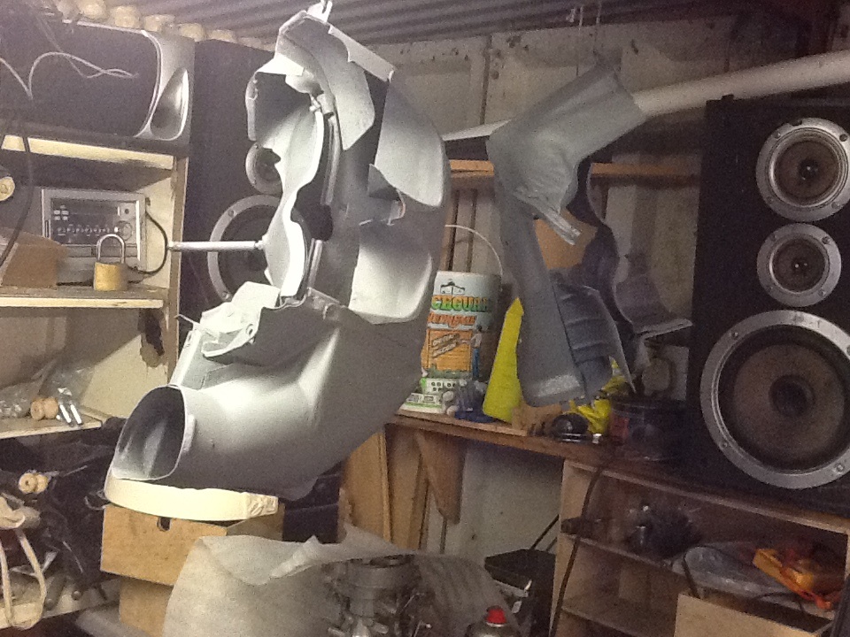

Actually been in the garage 2nite, haven't done anything useful really, just been arseing around with some paint, if you can see what I've done through the background of shite in my garage!!! :lol:
Got the summer hols coming up so will make my best efforts to get some mink done!! :lol: :lol:
