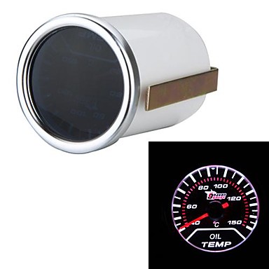

Post Re: Economy Temp Guage
Taskos wrote:
That's for water temperature. :|
So, whats the diffrence...... I wouldn't go much over 120 degrees for oil...
Rusty I think with some fiddeling you can even use it for Lambda controller....
I like it.... cheap cheap cheap...
January 24th, 2015, 12:43 am
Here you go....
http://www.lightinthebox.com/nl/auto-motor-universele-smoke-lens-2-52mm-40-150-c-indicator-olie-temp-gauge-witte-led-tempreture-meter_p2656118.html
Exactly what geo says, temperature is temperature,
if you want to have it a bit more fancy looking, take it apart, redo the interior change it into oil temperature, and put it back together.
I ve seen people putting the sensor in the valve covers, or in the center of the oil sump drainplug. I vaguely remember on (visa) engines there is a flat spot somewhere on the sump where you could drill and tap thread and put the sensor in (take the engine apart for that ;) )
Greetzzzz Rusty
