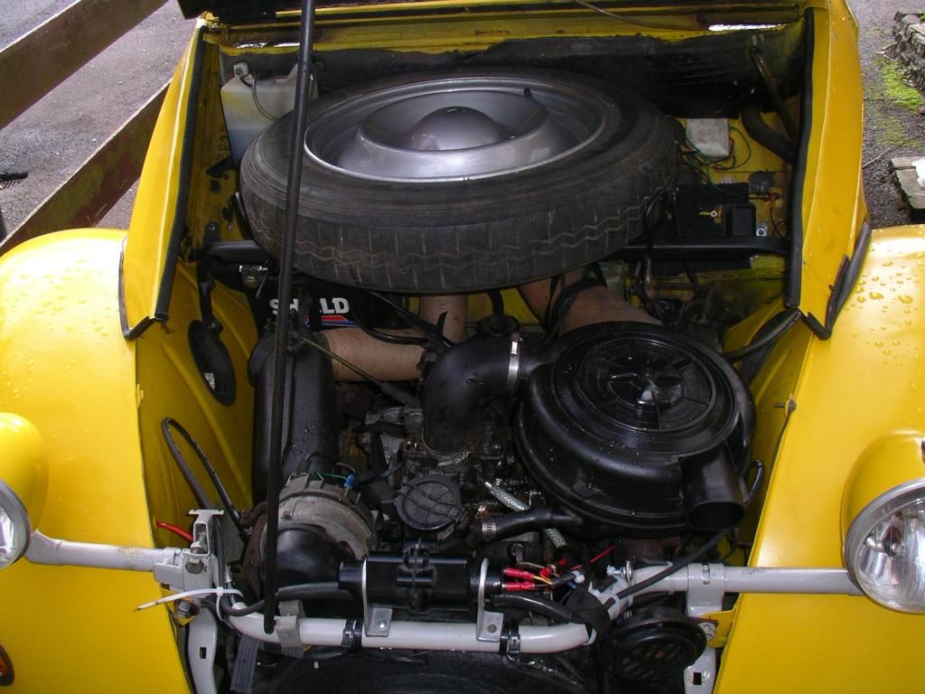

Would it be easier to mount a second van tank in the spare wheel housing and move the spare wheel under the bonnet like the Akadiane.
Mine has a 2CV front end and the spare wheel still fits OK.

Also need to carry two spare wheels {one under bonnet and one in the side}. Big trip into Sahara and Atlas mountains next year.

Thanks for that Peter. I might just put another van tank in the side [spare wheel] and put a roof rack on for the spare wheels.
