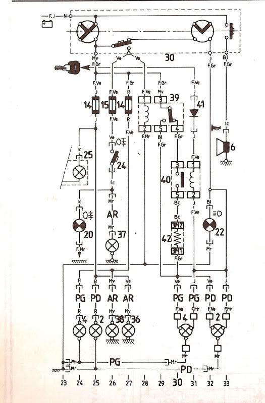

Definitely should be pins 1 and 5 on the 5 wire socket, which is what we did, to double check mine looks like this,
If it was shorting to earth after the switch then the lights wouldn't be coming on, I'm assuming they're standard wattage bulbs and are working fine at normal brightness?
Edit. After seeing Sean's post, if the wrong plug gets bridged then the dipped beam will come on dimly any time the ignition is on, it wouldn't overload the switch.

What is the black thing with two plugs on under the dash too, looks like a piece of wire runs through it within a plastic casing, that is unplugged, could that bear any relation to it?
That's the diode from the dim-dip, you don't need it, and now the relays are out it won't make any difference if it's plugged in or not.
The dim-dip diagram is here, diode is number 41.
