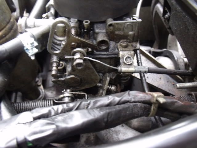

when you 'reconditioned' the carburettor, did you miss that little spring which pulls the strangler flap across as the fast idle cam is actuated by the choke cable?
Photograph is a bit dark, but you may be able to see how things look.
This is as far as it goes... by slcchassis, on Flickr
Another favourite is to trap the lever in the 'on' position as the carburretor lid is refitted, but that doesn't seem to be the problem in this instance.
Ken

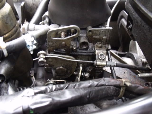

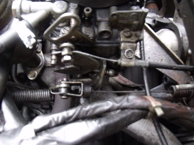

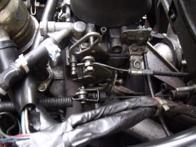

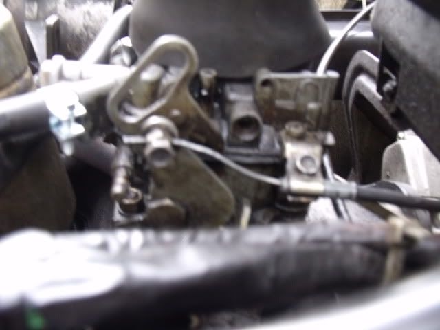

Hi .....heres my '88 2CV showing the choke cable .....
With the choke closed [on]
With the choke open [off]
And a few more pics I've just taken 5 minutes ago....
.....before it just started p155ing down with rain [and I had to put my car back in the garage and dash back indoors]
All pics taken from the L/H side of car.
hth
Terry
