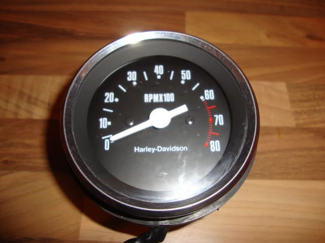

I've managed to get hold of a Harley Davidson rev counter at the right money.
Apart from the question of where I'm going to mount it there's the question of wiring.
There are three wires coming from it. A black one, a red one and an orange one.
I assume the black one is earth as it's black and it's still got a ring connector attached. Not sure about the other two though.

Red can be the 12v/live wire, from your ignition switch. Connect the orange one with the - on the coil and it should work I guess.
I've got a Honda rev counter, with three wires and just tried the wiring untill it worked.

Probably red going to the coil (the ignition side) not the + side
orange will be the light bulb (asuming theres a lightbulb inside)!!
Worked for me, look at
http://www.youtube.com/watch?v=vMu-Q4szf5s
the upper gauge is a rev counter!!

black is earth
red(+) feed from ignition on wire somewhere in the rats nest
orange is trigger(-) on coil
illumination will have to be by a seperate bulb holder with is own (+) and it earths through the body of the tach
Sean
edit orange is used as (+) on newer harley so try swapping the (+) and trigger wire if it doesnt work, they are quite robust and mine never suffered any damage trying to sort mine

got Harley tachos on 2 of our Dyanes, so I can check the wiring colours over the w/e.
Both of them have the instrument light fed direct from the '12 volts in' supply, so they're on when ever the ignition is on, maybe a way of drying out any moisture which got past the bezel seal on the bikes? :roll:
That'd be great Ken. Thanks very much. Don't want to damage anything.
I've had this one apart and it seems to be like that too.
