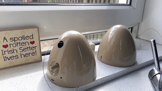

Dagmars ??
Painted shells, got lots of runs, will be redoing !

Post Re: We have liftoff.....
Thats a nice colour :)

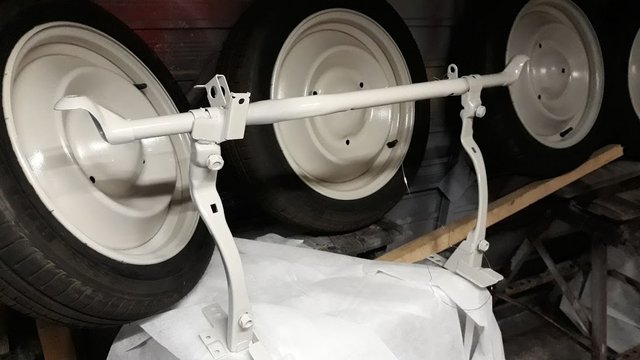

Some more small tasks complete...
Originals media blasted, primered and sprayed.....
Headlamp bar Shortened, blasted and painted
Headlamp bracket shortened ? What was the reason and where did you shorten it ? Thnks
