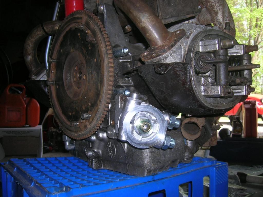

@Jasu
This was my setup for oil cooler + Filter with my clutch Fan.
The pipes + adaptor block are a tight fit but it can be done.
Removed the oil cooler from the front of engine, used proper oil pipe to bypass, oil pressure is very high when the engine is cold.
Also used a 120mm fan 12 volt with metal blades (from ebay) underneath the oil cooler, probably not needed.
The Oil cooler + filter all worked OK, but the Clutch Fan was not reliable for Road/Daily use.
Clutch Fan.
Oil Cooler + Remote Filter
