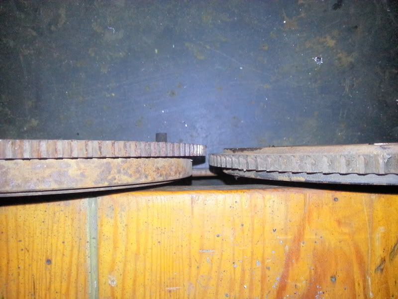

I just heard from my mate who has said not to modify the bellhousing! He said the ring gear needs to be moved instead, but I can see on a 2cv there is no more room for this because of a small lip...
See ami8i's post in this classic thread HERE, it was done for space saving but caused more clearance issues, only 1mm can be taken from there bell housing lugs.
I have a Visa flywheel with a 2cv ring gear on it and the top edge runs right to the face, I will take a pic of the standard Visa flywheel also which has the ring gear set flush with the face, when my camera charges...

Left is a standard Visa flywheel and ring gear, Right is a lightened visa flywheel with a 2cv ring gear set at the same location as a 2cv flywheel.
As you can see the visa ring gear sits flush with the face, on a 2cv flywheel there is a lip machined there that doesn't allow it to move closer... The difference is 5mm.

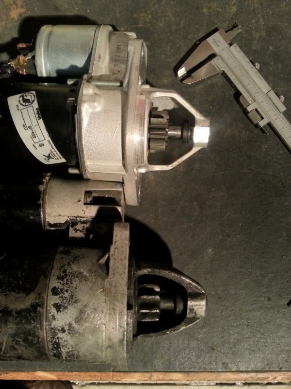

My solution is to grind down the face of the old starter motor I have, it has more meat on the flange than the new Valeo starter I have, which I will use when I get the Visa motor in.

Sorry not to have contributed earlier, but I think you're on the right track. I know I have to reposition the ring gear on the very back of the flywheel for my set-up to work.

I took 5mm which was around half the thickness of the flange .
Very happy with the results.
