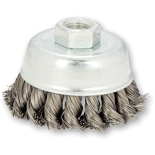

Smiffy wrote:
I used one of these to strip a door recently. Want me to take some pics and post em up?
I use this... and gas torch to warm color a little . Very good for removing rust and old color.

Jameswallace wrote:
ive got 2 drill attachments, one huge one ansd a smaller one, but i still think the dremel is the perfect tool (personally speaking) it gets into little gaps that the drill cant, such as inside the boot floor at the bottom of the rear sweep, was a small bubble on inside, now, sorted
i geuss its one of those things, tis like women with what fragerence they where, but with us men its tools :roll: personally i think that the dremel does the job, designed for it or not
Fair enough mate. If it works for you ... :)
October 14th, 2010, 8:22 am
Post Re: RUST EATER
When you say dremel, you're talking about one of those mickey-mouse things with the tiny spinning tools on the end? How long does it take to (for example) strip the paint off of a door? I'd have though it'd take bloody ages? I don't see what's wrong with a 4.5" grinder?
October 14th, 2010, 8:34 am
Post Re: RUST EATER
I think James is talking about dealing with tiny rust bubbles. At least, I hope he is ...
October 14th, 2010, 8:37 am
Post Re: RUST EATER
Yer but i havent had the need to strip a door. (yet) and i find its useful for littlebobscure bits that an angle grinder wouldnt get too
and yes i am !
