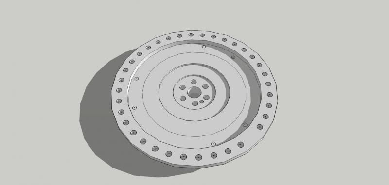

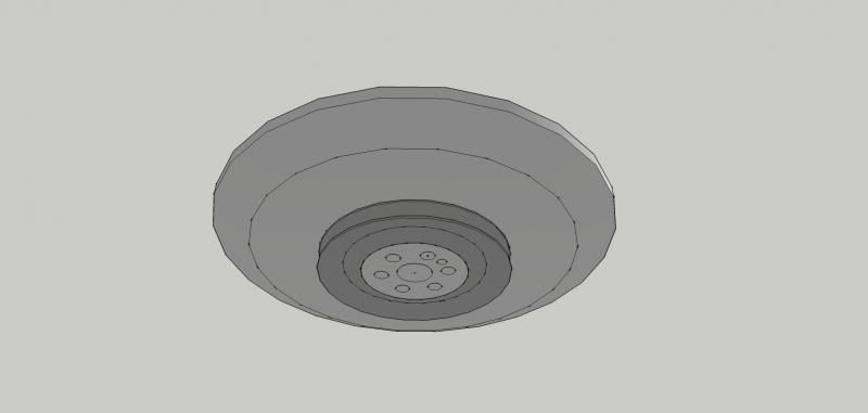

I am about to have a flywheel machined with the supercharger drive pulley mounted on the back of it, then have my brother tig up a plenum/intake manifold to mount it to, will run a tensioner pulley. This will mean the supercharger will be mounted further back so I think the throttle body will be able to sit right on top of it :-)
I can send you the cad file once i'm done with it if you would like to have one made yourself!
Here is the draft, still needs lots of tweaks, I will have a trigger pattern drilled into it in case I go for megasquirt sequential ignition later on.

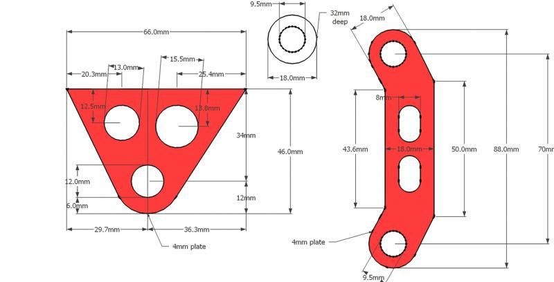

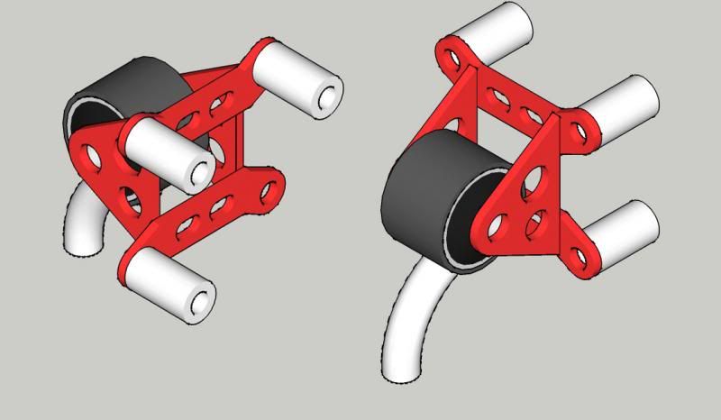

Here's the plans for my gearbox mount if that helps:
Harley

@harley
Drooling over the flywheel super charger option, but ring gear??
April 6th, 2013, 11:01 am
Posts: 816
Post Re: Shortening Track rods
subarupete wrote:
@harley
Will use 2cv ring gear and have them fit it. :)
