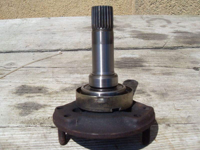

Ken, do you think it is ok to drill the GS disc brake and do one bolt through spacer and all or should I drill output flange to suit the GS disc then use the adaptor with separate bolts to the flange and to the drive shafts...

Hmmm, this is an interesting development :? I did this swap the other way around, LNA flanges into GSA 'box, and it appeared to work fine. However from what you're saying it sounds like the splines might in fact be a bit of a sloppy fit, which won't do much for their longevity. I would have liked to have thought I'd have noticed when assembling it, if that was the case, but maybe not.
I'm going to pin my hopes on the fact that there are two different types of GS flange, the tripod style you've got and the full circle ones I've got, and I'm going to hope that mine are a direct swap.
AH AH, wait a minute! I've just had a thought!
I've got the left over GSA and LNA flanges as well as the LNA gearboxs in the shed at work, so I thought I would go and measure them tomorrow. Then I thought further about where the GSA flanges were, I put them on the LNA 'box for safe keeping... BINGO! Therefore they do fit.
What you (both) need, I'm assuming, are the full circle type GS flanges. This also backs up my theory that the LNA 'boxes share more parts with a late GS/A box than an early one.

Hi ,
It is the Ln spline that is slightly larger dia. I really need to get myself some calipers ... but the eyes say it's a bee's dick different...

The threaded ring also seems different, the GS input flange fits into the Ln box but, sloppy, but doesn't screw up...

I had a look at the GSA output flange, spline dia 24mm, shaft dia 25mm, and looks like your LNA one to me.

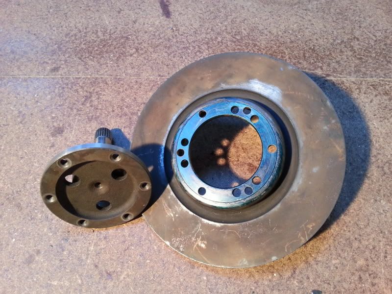

I got the machined discs and input shafts back :mrgreen:
The input shafts were noticeable wobbly on the lathe despite trying different methods to clamp them.
