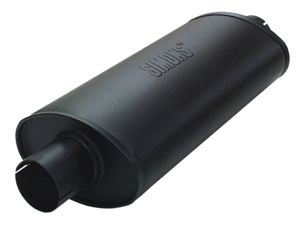

About mufflers
I think I'm going to order something like this,
http://www.simons-uitlaten.nl/contents/nl/d538_Simons_Universeel_63,5mm_uitlaatdempers.html
I'm looking at this one "ovaal 115/185mm, lengte 42cm"
These are a straight fit to the existing pipe I already have...
