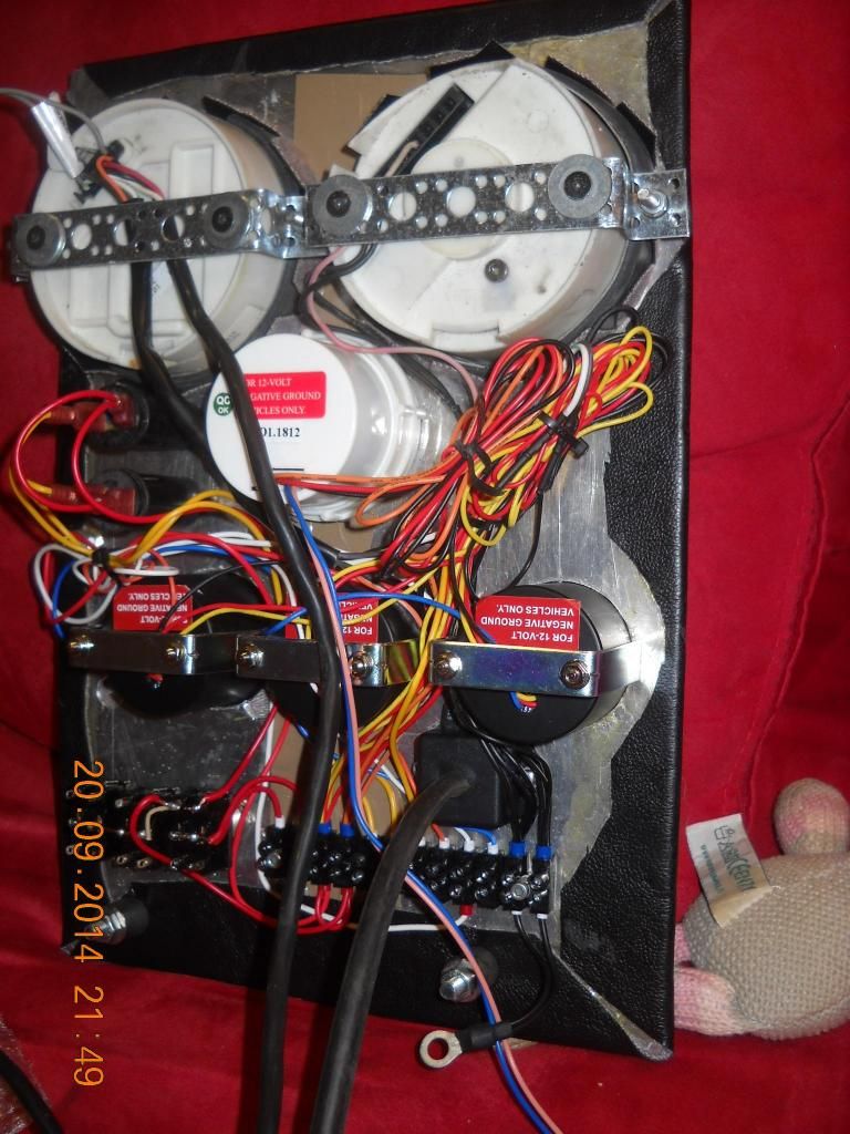

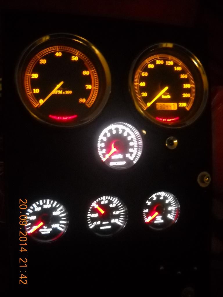

Posts: 508
Location: Korpilahti, Finland
Post Re: Rev Meter/Tachometer
This one looks nearly same than "the too new" version, model year and backside are the best way to recognise correct one...
That is how they should look from behind. RPM gauge works perfect and speedsensor is also possible to install to 2cv gearbox with quite accurate speed reading...
One photo of speedsensor, reading teeth of the rearmost gear. At 2cv6 gearing, it is almost correct, 2cv4 doesn't, need to check for AMI8...
