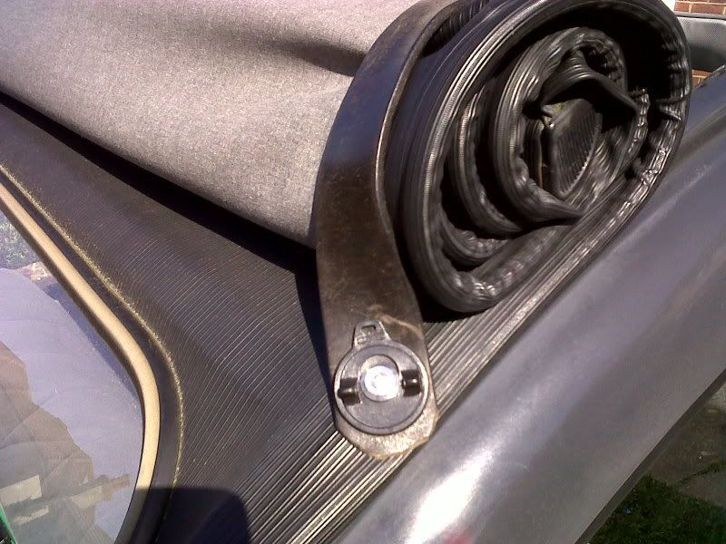

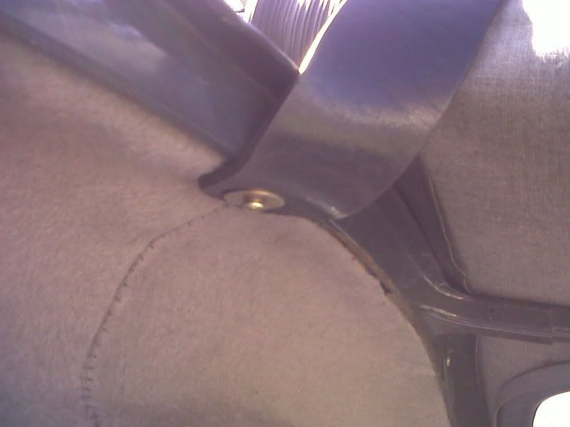

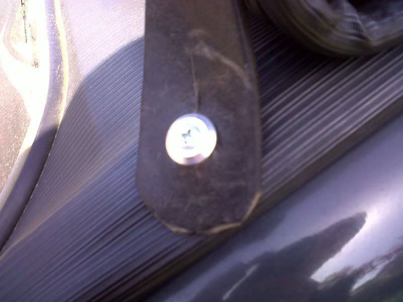

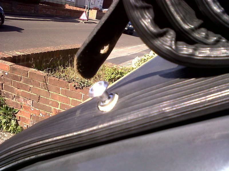

Well i went to hobby craft, and they didn't have what i asked for. so i came back home and looked through a box of some old nuts and bolts and i found some guitar buttons, i also had an old belt so i figured it was worth a go since it was free!
They stick out a bit further than the old poppers obviously, but with the same amount of self tapper cleared the bottom so it went in the same place.
The only thing i need to adapt is i need some sort of tube spacer in the belt to stop the screw from moving when the strap is moved to have the roof up or down.
Then to make them extra safe, i put a pair of strap locks over the belt. i am thinking about swapping these with some metal ones, but the plastic ones seem to do the job!

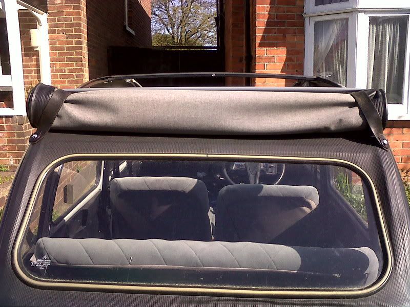

And the final look, I reckon it looks quite tidy for an old bit of leather!
