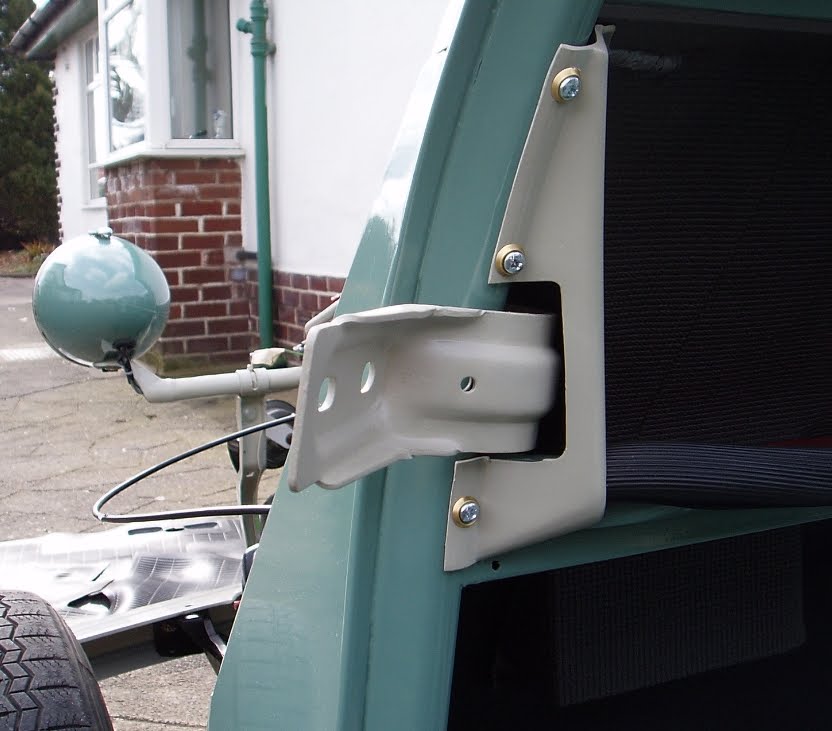

nail glued the trim in!
it was originally held with self tapers!!
those seat covers are the best of the modern Cit ones and will happily go through the washing machine, but the older ones that dont have the sides would be more appropriate to your look
get Mrs Nail involved with the sewing machine :lol:
Sean
Sean the hinge covers have been secured with self tappers. It was the interior trim on the sides of the body I was referring to there, the grey felty stuff. I put it in and it stayed in without glue so I left it, but then decided to glue it anyway to do it right.
