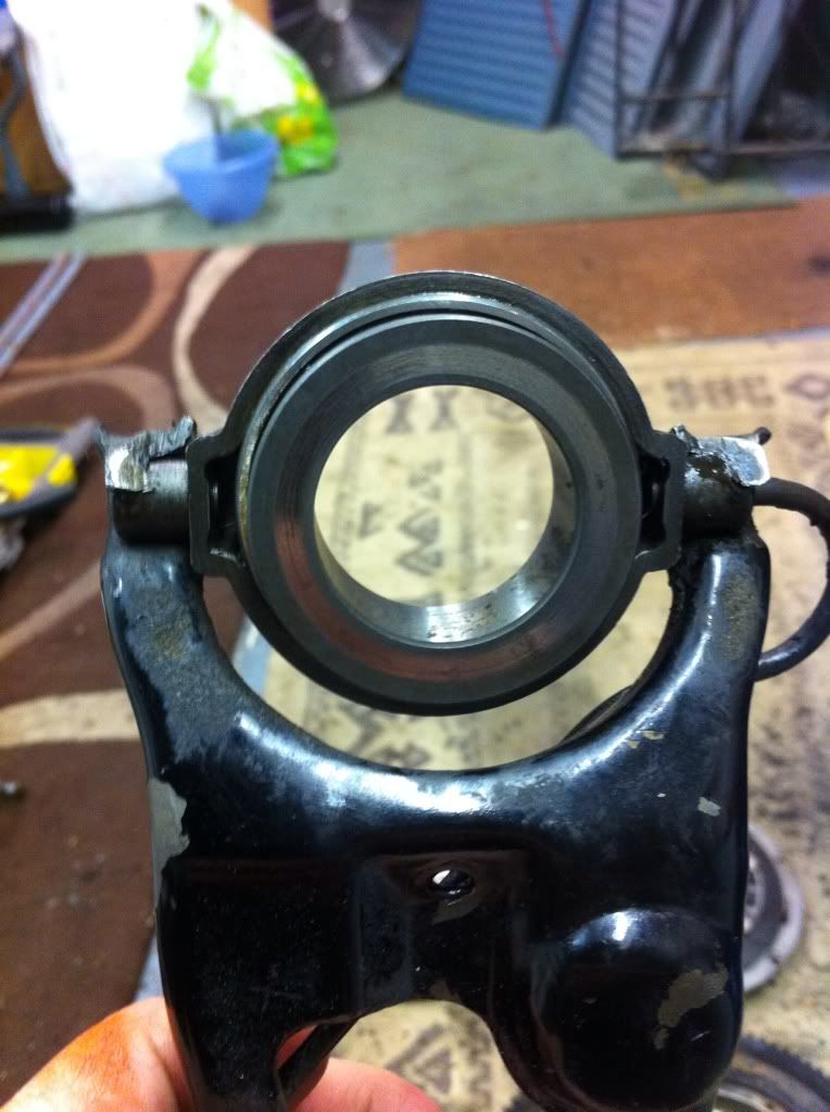

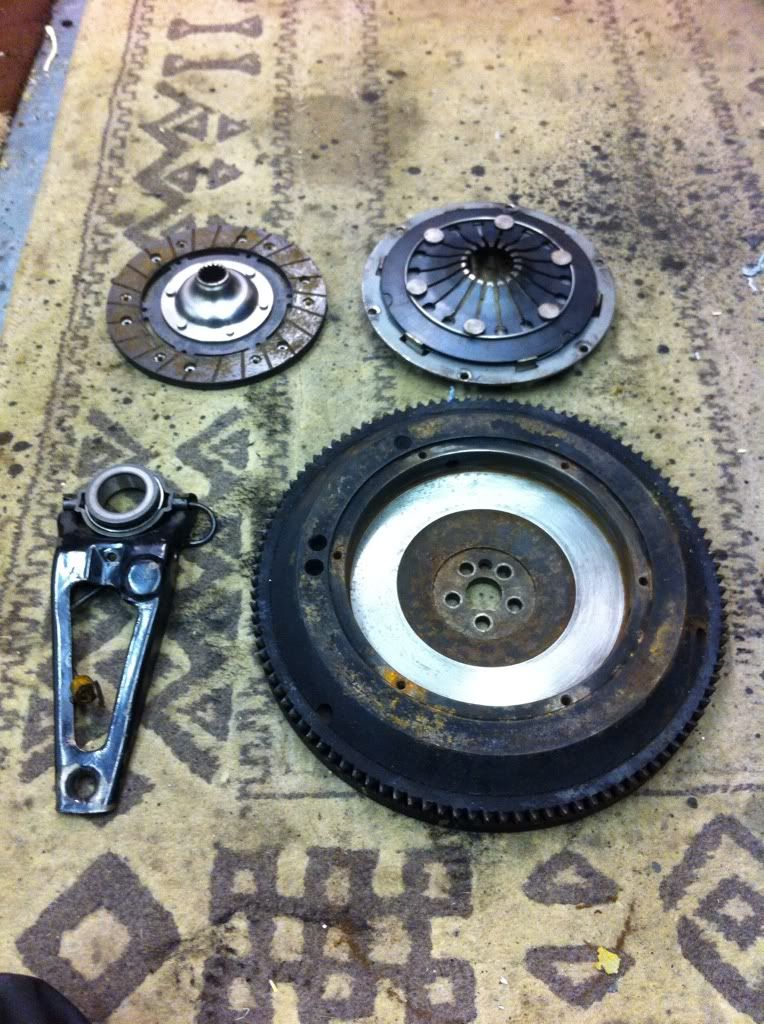

Clutch next.The van has the heavy flywheel fitted,but has not got the carbon type thrust bearing.The whole unit is obvously new,as there is no wear on the clutch plate,and it just looks new:D

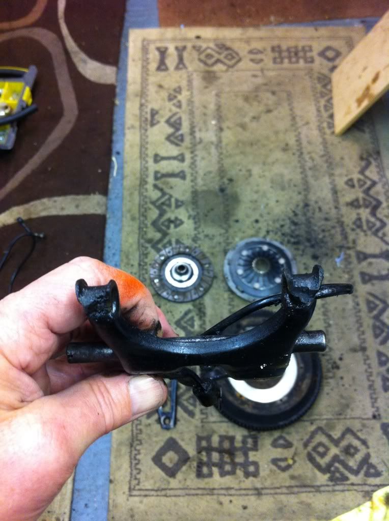

The operating arm has suffered some damage where the release bearing is held in place.There are no signs of rubbing on the cover,so I am assuming it must have been rubbing on the old unit.I was given another arm in a box of bits from Rythem Thief,but that is excactly the same.
I will refit this clutch as there is nothing wrong with it,and it was working,even though there was so much play in the pedal due to the bushing on the bulkhead hanging off:eek:
If anyone could throw some light on the clutch arm damage,that would be usefull.I think that it must be a common problem as both arms have the same damage.

ive got a heavy flywheel in my garage, bit rustier than yours though
i may one day get around to fitting it to my car!
