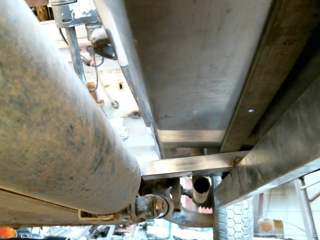

anyway here the 3/4 done foot plate, a relief to have that in and locates the body , you see the 2nd part of the floor to be connected stil, its actually dead useful to have this not welded, it give great access to the suspension stuff from above...I might join the 2 parts with bolts instead of riveltting..I don´t know how the MOT / ITV people stand on that issue??
also for ken the gap for the silencer is ok, If I cut it about 15cm shorter it will fit well between the cross members of the floor
by the way this is fotographed in reverse, from the computer the car is left hand drive
