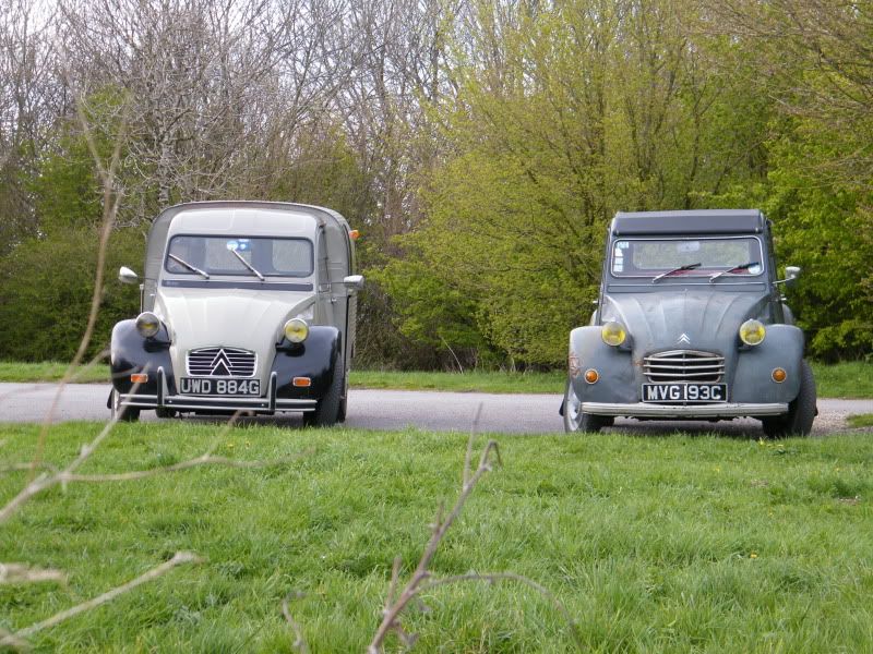

Post Re: 1965 2cv ENAC
April 27th, 2012, 10:08 pm
I like!!!
April 27th, 2012, 10:28 pm
