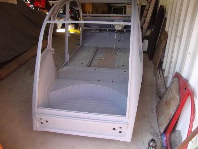

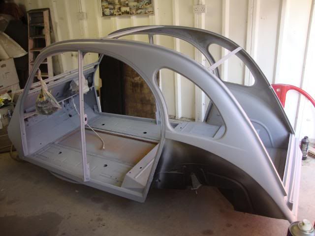

She's finally in primer:
Surprisingly straightforward too. I assume that high-build primer is easier to spray than gloss but nevertheless I only managed to finish up with one little run.
Off to get 5 litres of Celeste Bleu celly tomorrow (which I expect to be a challenge in itself.)

I did a coat of etch primer on any bare bits followed by this high build cellulose primer. I done one or two coats all over and five or six coats on the bits that will have to be most shiny (rear sweeps, front a-panels, windscreen surround).
Started flatting it back yesterday too. Got it smooth as a babies bum on the nearside rear sweep.
It's going to be a long week or two of rubbing down to get her ready for top coat.
