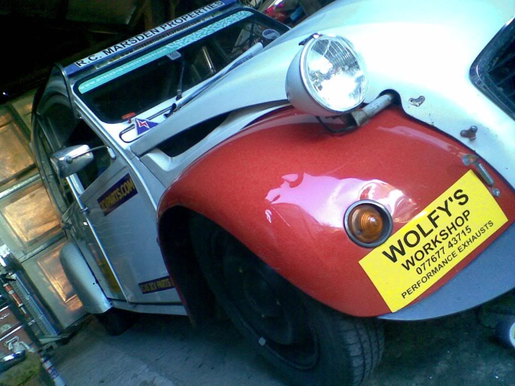

I like but think I'd probably go the other way round with white roof and red spanner-I quite like the idea of a slightly more "heat reflective" roof colour as it gets a bit warm in there! ;)

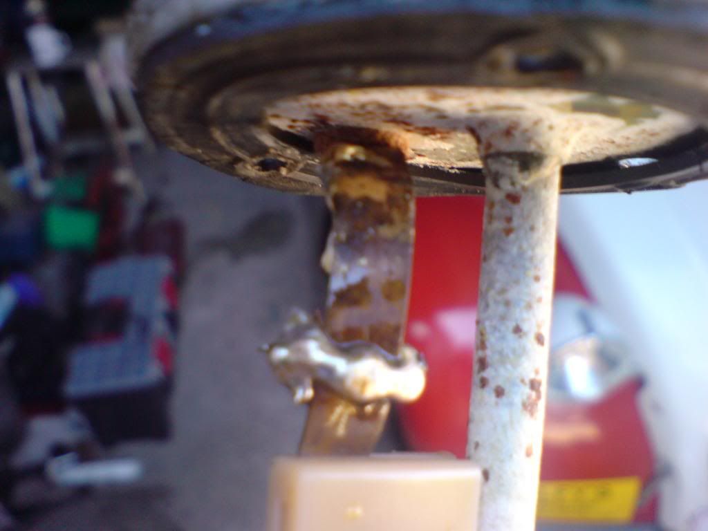

Back to the present, I had another look at my fuel gauge sender unit this morning and decided to do (in theory) a slightly more permanent bodge, look away if your eyes are easilly offended.....
I drilled 2 very small holes in the broken metal thingymebob bit, wrapped a length of wire between the two and soldered them together-ugly but, theoretically functional.

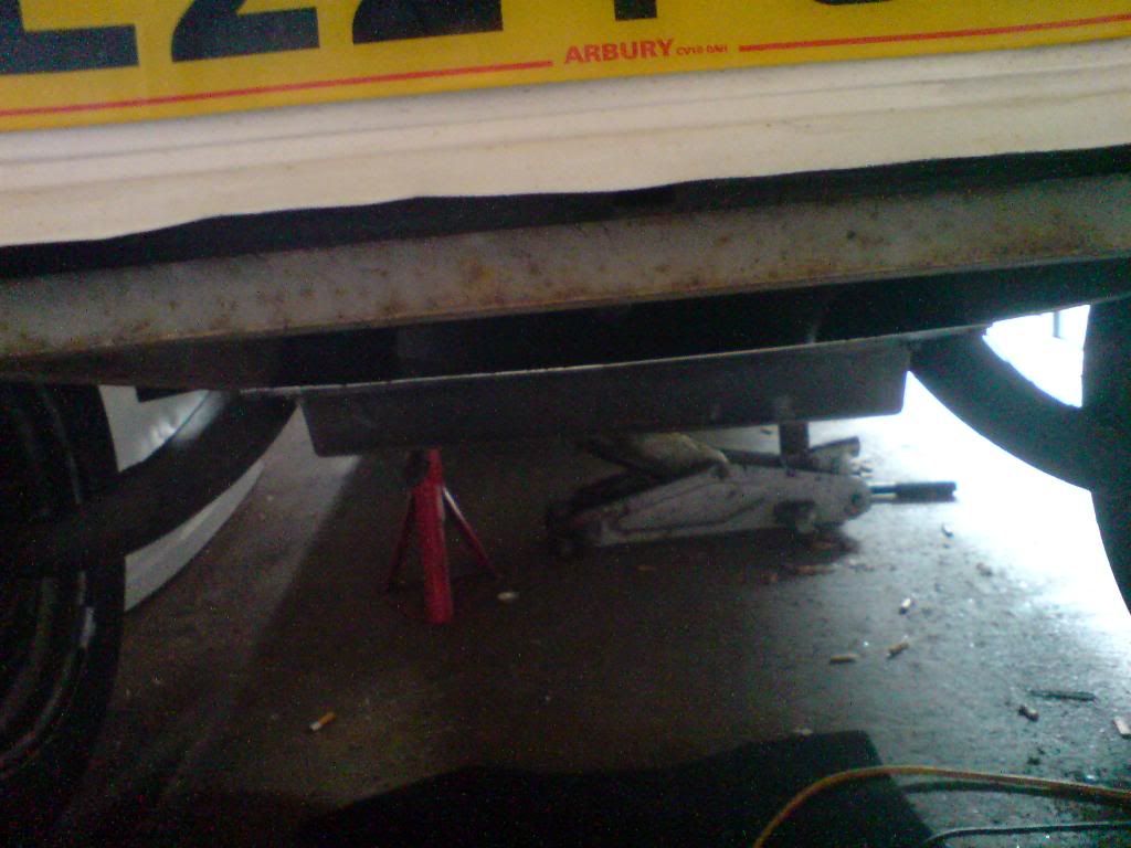

And, as I've now got the fuel gauge sorted, I don't really want to have to take the tank back out in a hurry-especially not because I've worn a hole in the bottom of it!
So, I've finally managed to pull my finger out and fit a tank guard at last!! :ugeek:

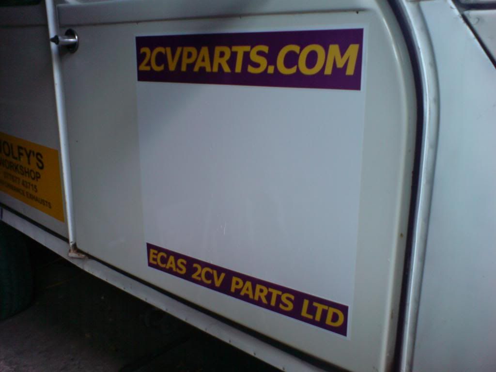

So, with the wings refitted and the bumpstops removed, I now realise that I've been running on the bumpstops since I built it! :lol: It's a wee bit lower now, just need to level it out side to side, get the new roof painted, sort the dampers, fit the new steering column and fit the number sticker on the passenger door and it's (practically) done. :D
