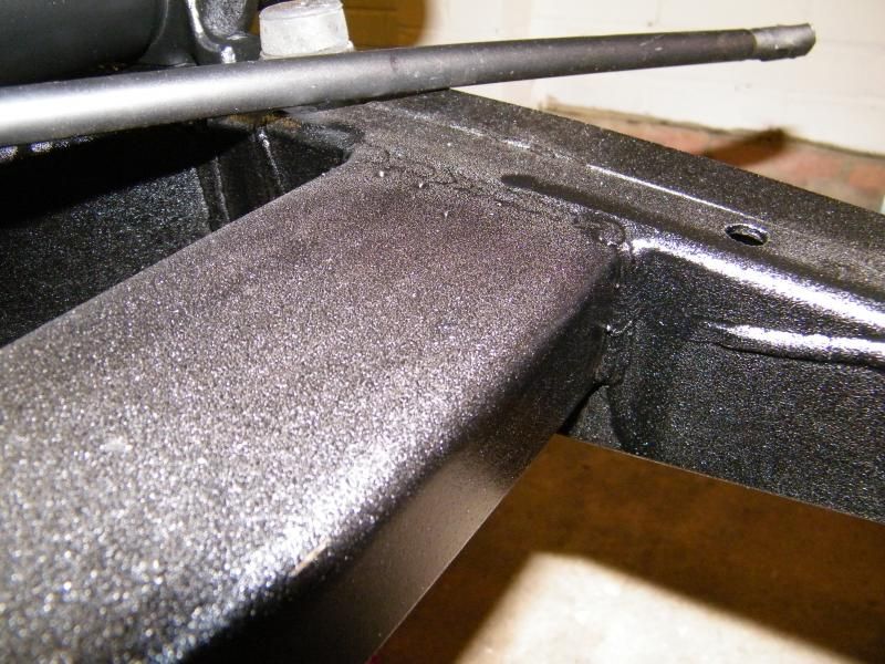

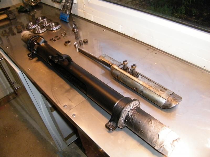

I didn't get a great deal done, but the rack is back in one piece and this time it works.
A few pictures showing the finish on the chassis with the shite tetrosyl product and heavy blasted finish and the rest of it with a wire wheeling and decent paint.

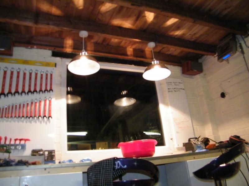

Finally got the lights wired in over the bench, now I can see properly. I might go and get a couple of flourescent tubes tomorrow to go over the front of the car, or I was thinking about halogen spotlights, any opinions as to what may be better?
