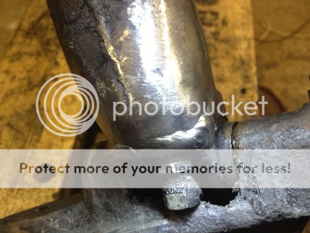

Well it had to happen the start of the year and work got in the way and slowed progress on my Dyane..
At last it was time to cut down the front arms and rotate the king pins....
www.evilbens.blogspot.com

Post Re: The Dirty 'D'
After working out that the wheel needed to sit in the middle of the wheel arch 60mm was the amount needed to be removed....
All smoothed off back to the factory casting.....

Posts: 328
Location: Cornwall
Pie cut back down to be a tight fit back on the king pin and rotated and lined up back on the car...
Then the pie cuts welded and fully seam welded back into place....
