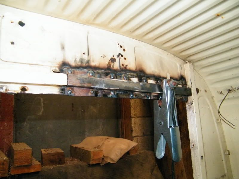

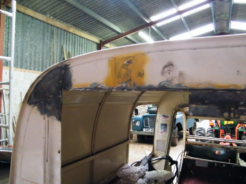

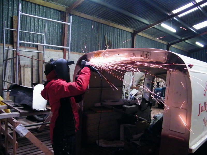

Anyway, back to the van. I have barely done anything, had exams all through January, but the last of this lot is Wednesday, so hopefully I can get back to more important matters then. I've now started on the back of the van, Alice came over and lent a hand as well (It's useful having friends who can weld / are handy with a grinder! :D ) we discovered yet more holes, as expected.
(Couldn't find goggles, mask works fine)
That bit is turning out to be a nightmare to weld in, I don't know if I've just lost the knack of welding, or whether something is up with the welder but I just can't get a consistent arc. I think I'll see if I can get some Argon/C02 mix, apparently that's easier for thin metal.
Looks not too awful at first, but when you shine a light behind it all these spots appear;

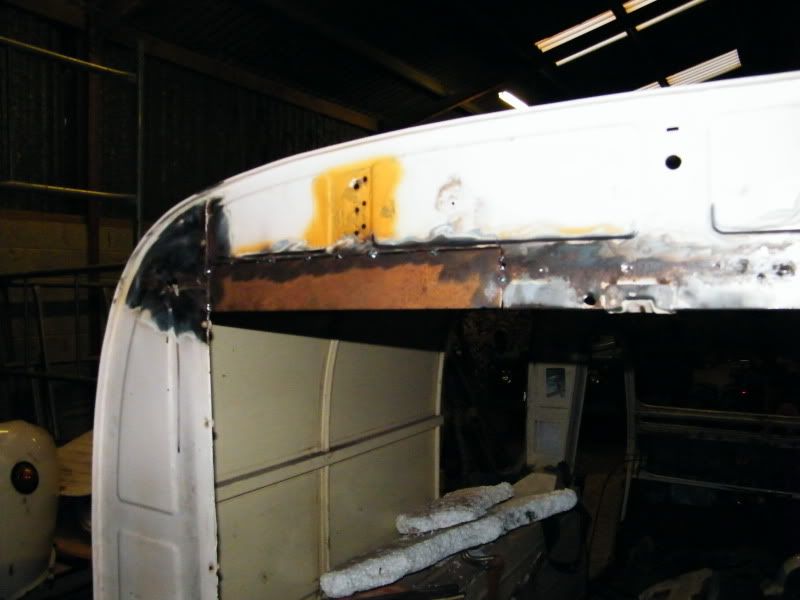

All I did today was make a new section from some scrap sheet to go in behind that repair section, and stick that in, before running out of gas.
Getting there slowly, oh so slowly... :|
I know it looks horrible now, I'll get a bottle of Argoshield and try again soon - It's dreadful wasting all my time at school when I could be doing this! :roll:
