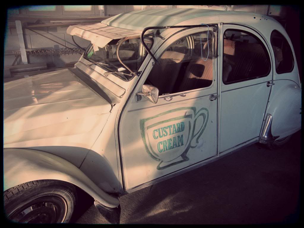

Post Re: sidney has entered the building
fixed the front wing rust and other rough bodywork spots, which led onto starting the aged sign writing
Timewarp back to the early '70
I like it
