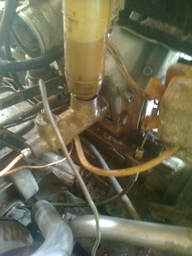

ok quick update, yesterday was tricky, the pedal box needed raising!, first the brake oil container was seized onto the pump, making life very difficult, after finally discovering how it all went together without breaking anything the master cylinder support was shaved and raised . again the 2cv triangle bulkhead comes back to haunt and cause problems with the angles and distances for the clutch. so all that had to be redone and reinforced also. in the end it came out ok, but If I do it again it would be thought out more beforehand.

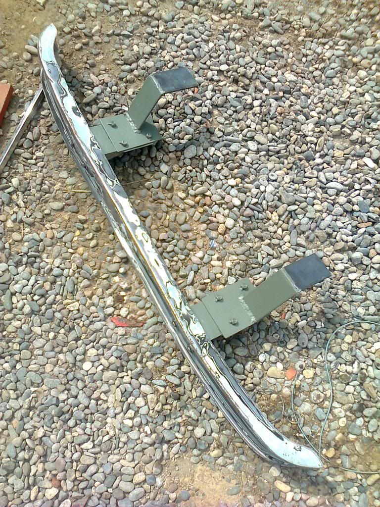

this morning a relatively easy job of the new rear bumper bracket, which is now on.
