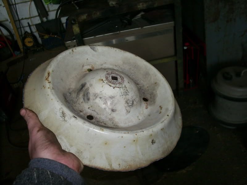

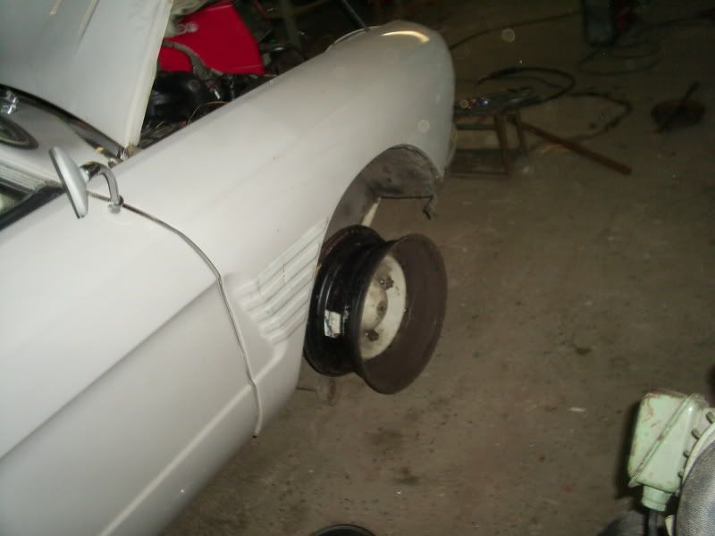

Here's the progress so far on the wheels. I'll finish them when I have time but I doubt I'll fit them on the Ami now.
The outers are from a Ford, I managed to find a set of four in the breakers for peanuts. I cut the centres out of the 2cv wheels with a plasma cutter then put it in the lathe and turned it down 20 thou at a time until it was a nice interference fit in the rim.
