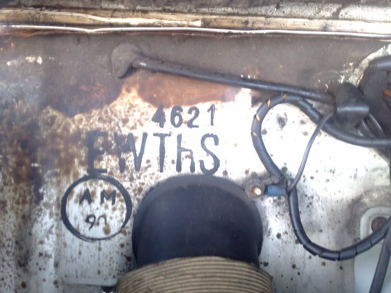

Post Re: Where was my 2cv made?
Knightley
Your RP number should be where the pictures in this thread show it. Around the demister inlet on the drivers(uk) side,some are above the paint codes, some below.If it's not there you've either had a respray or work has been done on the bonnet hinge and it's been oversprayed, or its just faded away, they were not stenciled on with much enthusiasm.The Chassis has nothing to do with it.
If there's two letters and two numbers in a circle they tell you the model code and model year.
So what does AM90 in the circle mean then??
September 20th, 2011, 7:51 pm
AM = Annee Modelle = Model year..
So yours is a 1990 model car ;)
Thats odd cos the orca production generator says that 4621 = 4th July 1989
and the registration document says first registered on 31/08/89
So how can it be a 1990 model??
September 20th, 2011, 8:36 pm
model years tend to start in the middle of the year instead of the first of januari ;)
