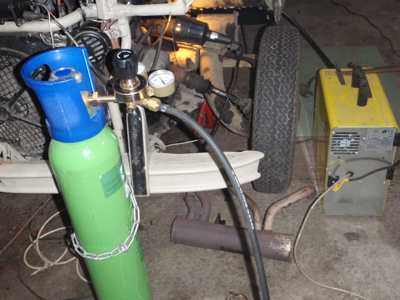

Forgot to mention that I bought this not long ago in the UK

That gas bottle looks like pure argon what you need for using gas is a mix of 95% argon and 5% co2.

Ya well I know but I'm stuck with it. Can't just return it for a swap so I'll ''learn'' to weld skinny 2cv's with pure argon. What would the result be?

It's difficult to use and produces cr@p welds on steel, according to this source.
http://www.mig-welding.co.uk/welding-gas.htm
