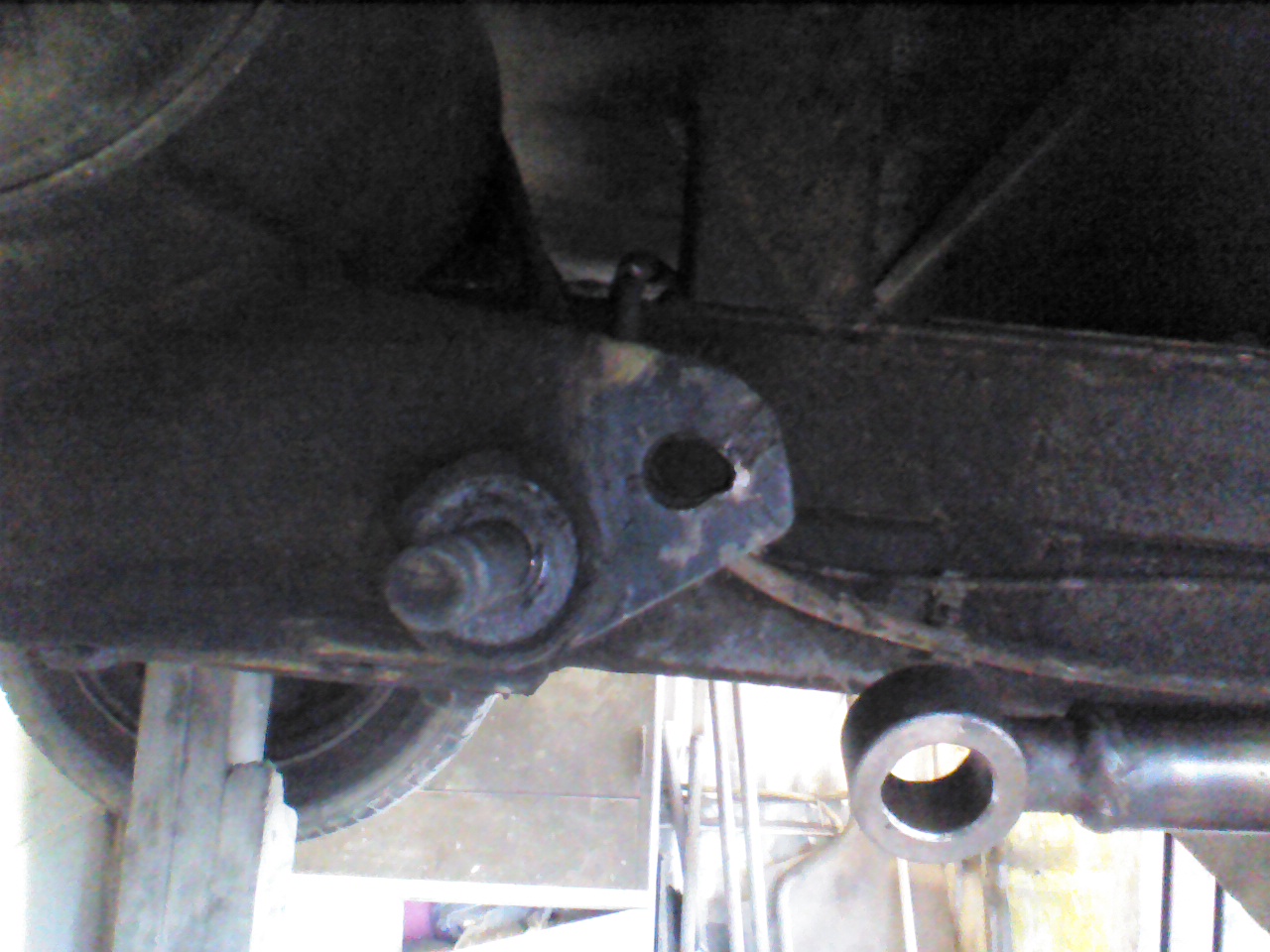

What manner of fuckwittery is this!? :evil:

Picture is a bit vague, did they manage to put the knife edges the wrong way around?
July 24th, 2014, 7:25 pm
Oh dear.

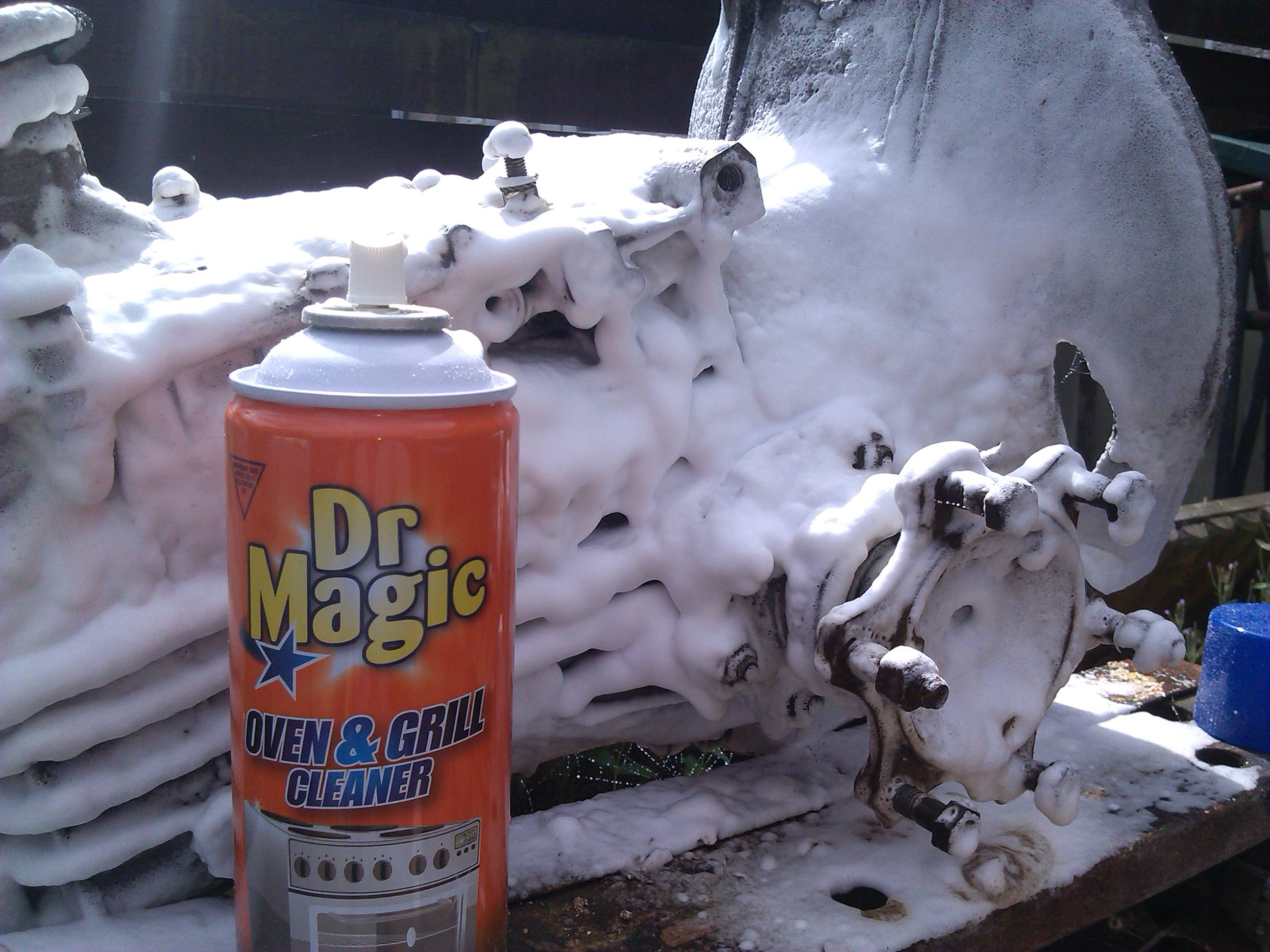

piddled about getting brakes and a gearbox ready for Anglsey
cleaned off for for getting picked up next week
bearings and selectors done last year.
After good success cleaning up Landrover Carbs went off to Asda for a couple of tins of oven cleaner off the £1 bins spray it on brush it in to the stubborn stuff.

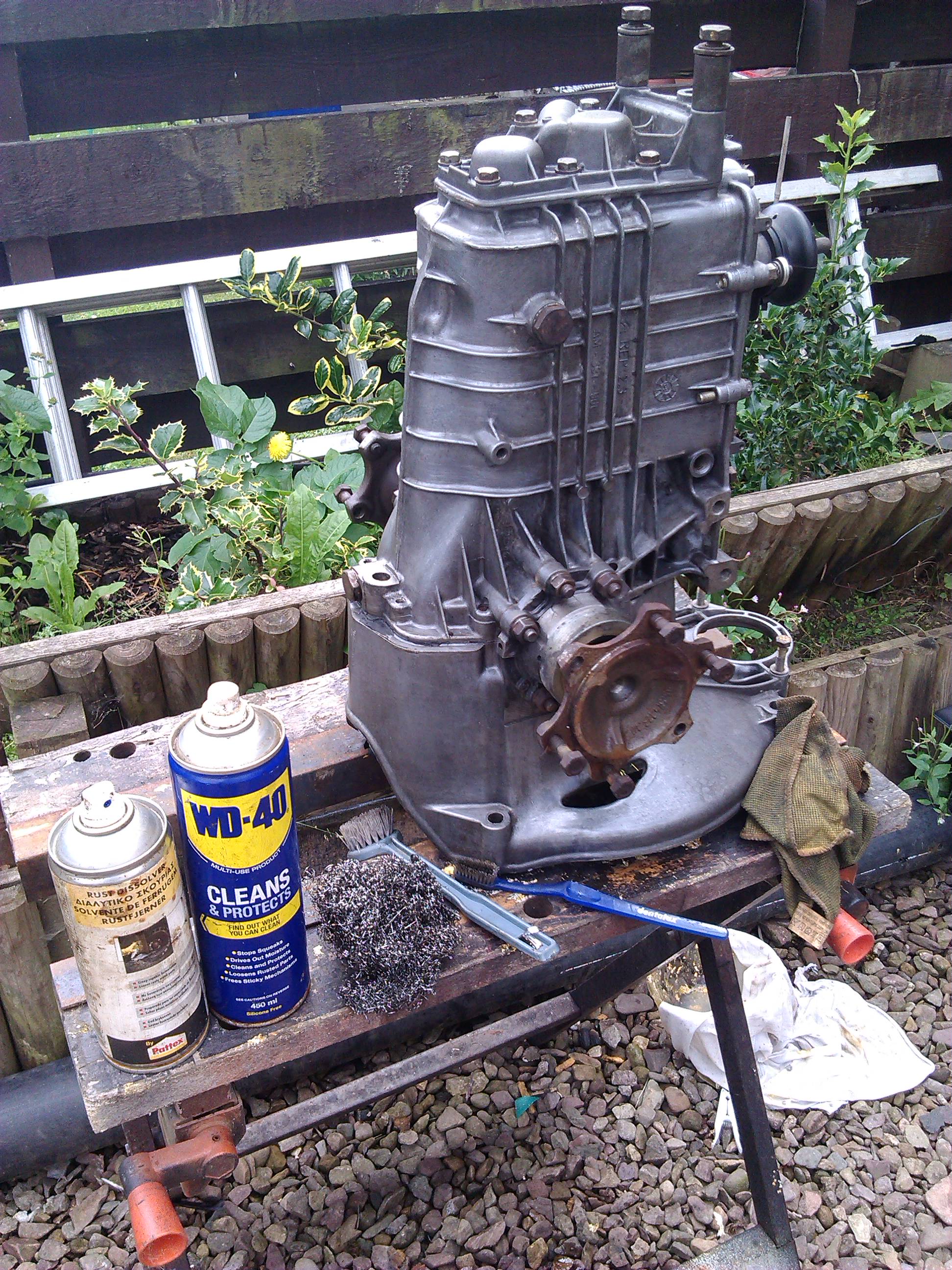

rinse it off with HOT water and detergent ( flash or the lidl equivalent) in a presure spray bottle and before it can dry off spray with WD40 which chases the water off the surface and stops the salts in the cleaners from oxidising the ally.

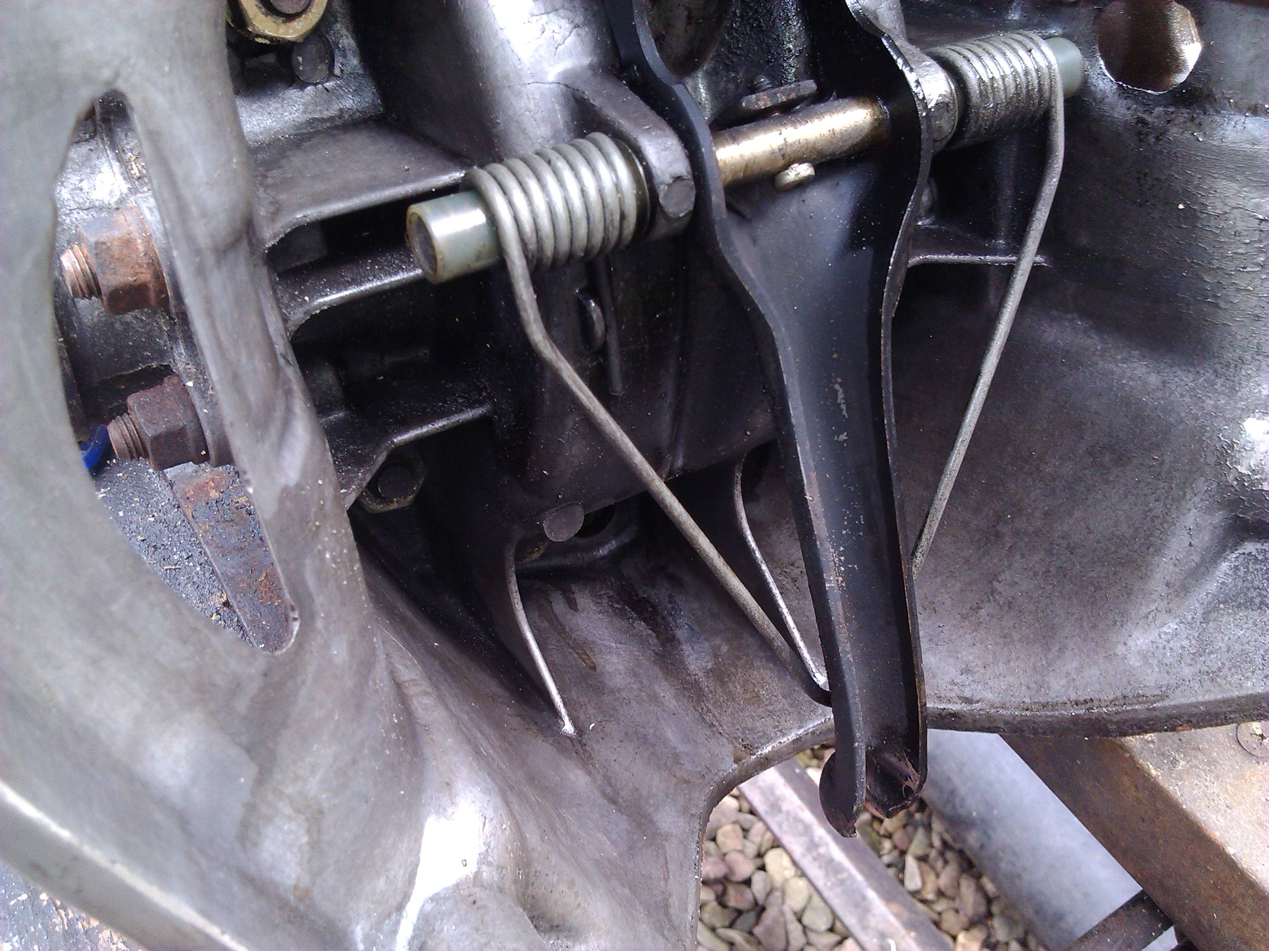

result - buffed some of the sharp corners and mould flashings off as im always knocking my knuckle off on them during the race
