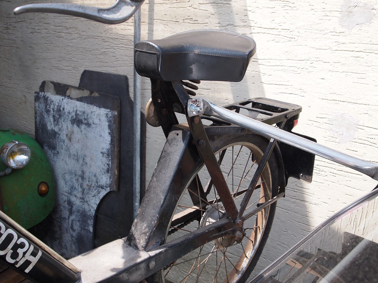

Made a rack to carry the Solex on the back of the 'daily driver' 425 - that should slow it down... :lol:
pics please....

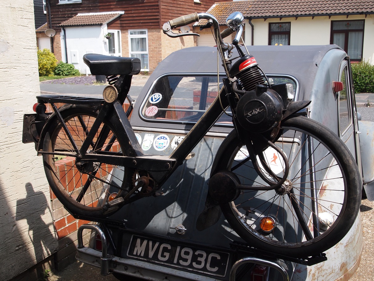

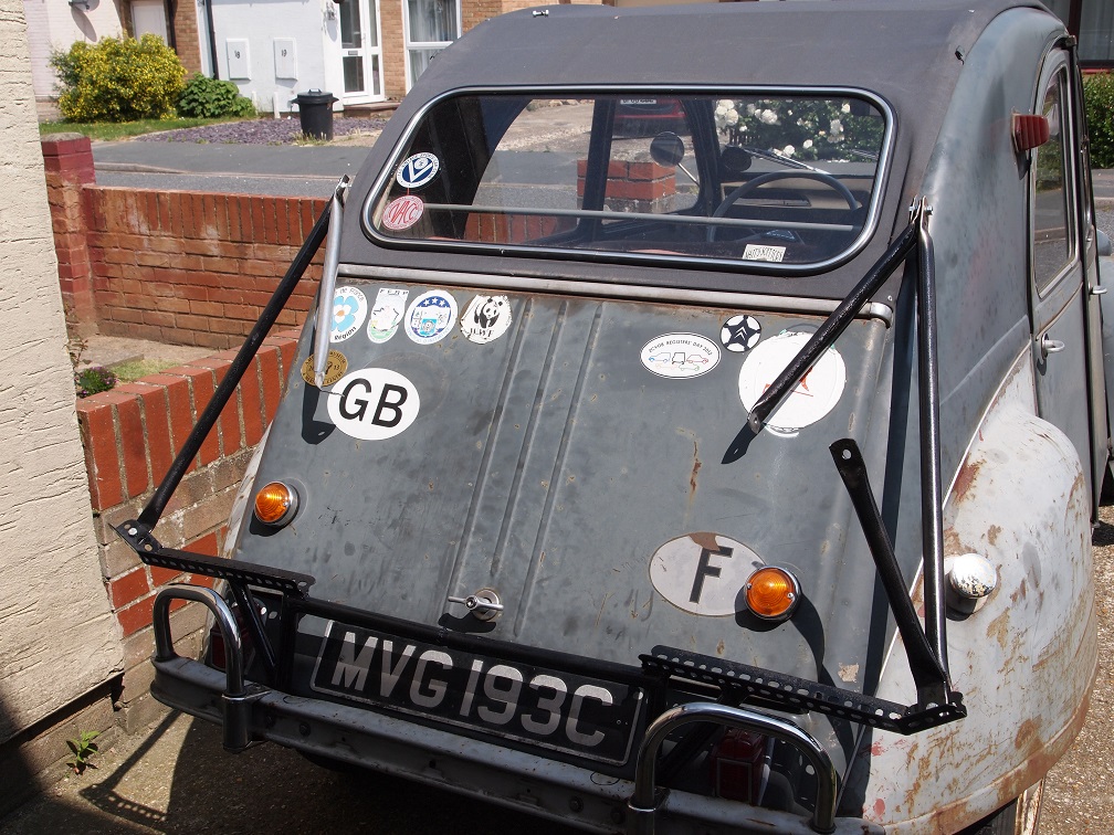

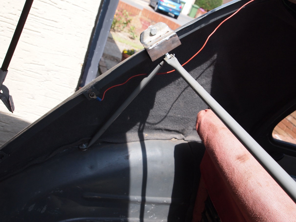

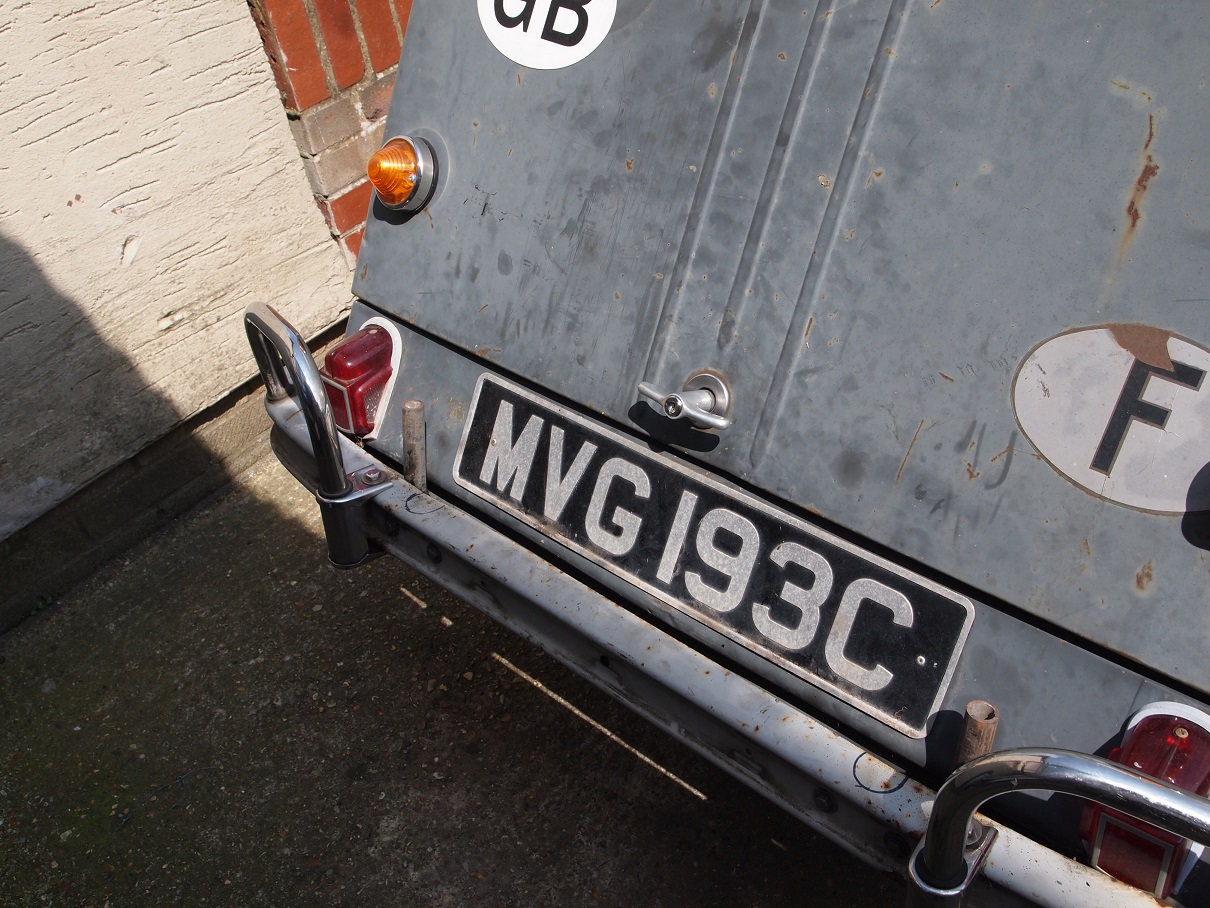

Solex rack. Made of bits I had kicking around with the help of a lump hammer. Made up new rear dumb irons in 3mm plate with 3mm angle iron welded across rear with 2 pegs to sit rack on, bumper bolted to angle in normal position.
Made a frame out of 1" ms tube to slot over pegs and carry 2 bits of Dexion to sit wheels in.
Serveral goes @ making top brackets to slot over cant rails, then faffed around working out how to keep them in place. Then just a case of making struts (1" tube again) to connect it all up. Bike bolts to it. Only mod to bike was to bolt an angle bracket to top of left front fork to bolt top strut to, it was just easier than finding another way of holding the heavy end. 3 bolts, the fork bracket, adjusting hole on seat post & front axle bolt, back wheel gets strapped to its bit of Dexion.
Lights & numberplate all visible.
See it perform @ Registers Day (I hope!) :)
Here with pics Geo :-

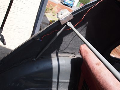

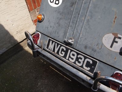

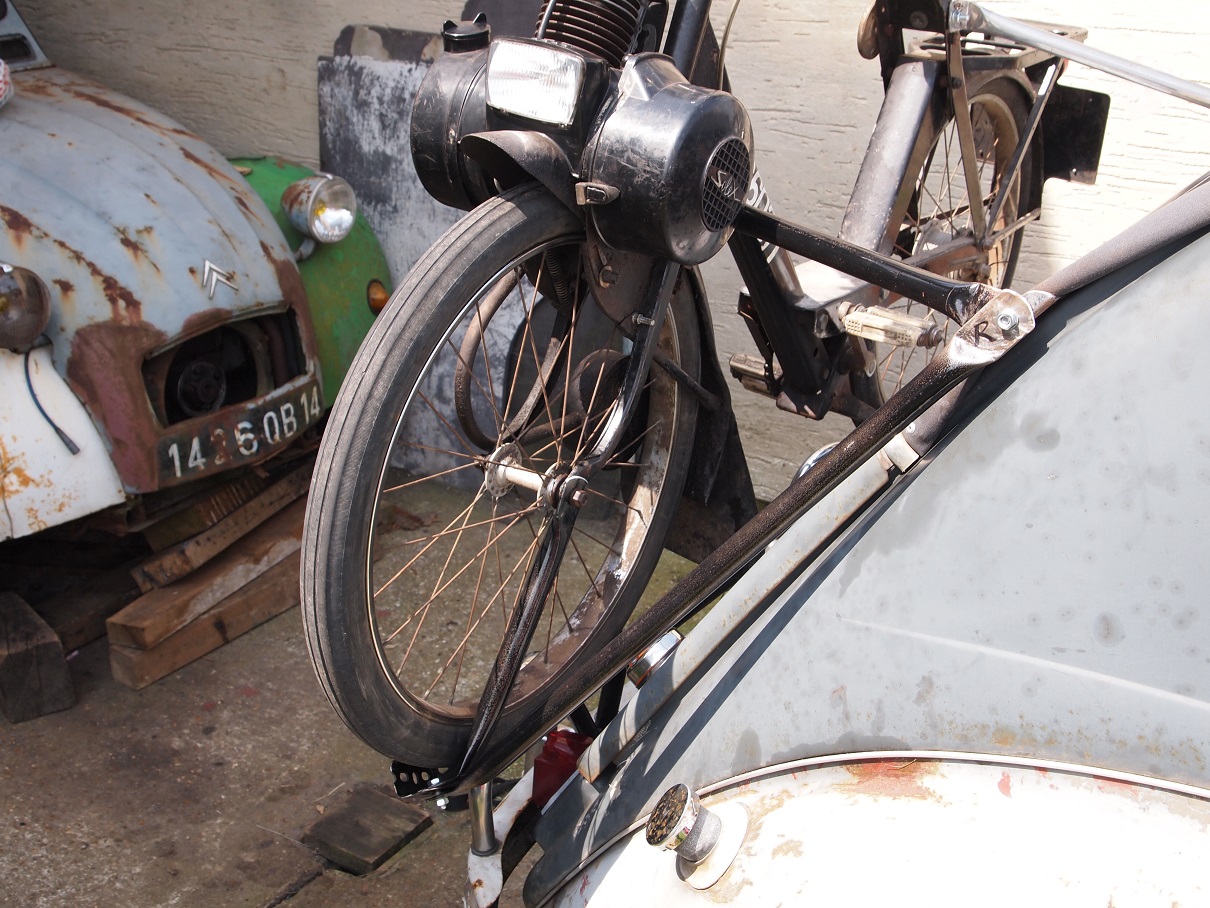

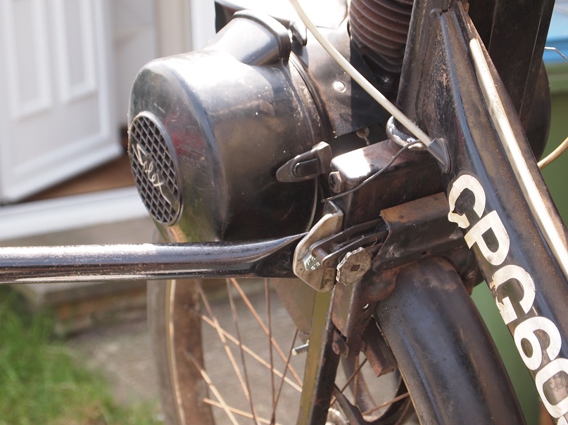

Top bracket 'rigging'. cross strut holds brackets against cant rails, vertical stops it moving up & down, picks up wing bolt..jpg
Top bracket 'rigging'. cross strut holds brackets against cant rails, vertical stops it moving up & down, picks up wing bolt..jpg [ 254.1 KiB | Viewed 2699 times ]
